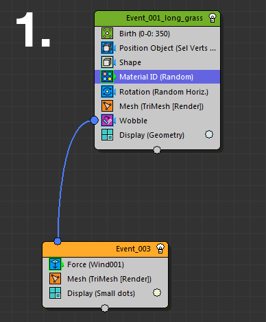

I have six objects and a multi/submaterial (6 slots) in my scene. The different objects will be scattered on a little plane via Tyflow (image 1.). Via material ID operator the different materials in the  multi/submaterial are distributed via random (1-6) on the 6 different objects. This works fine so far.
