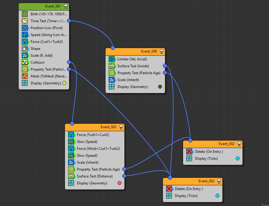

Hey guys, I´ve searched on the forum and I couldn't find what I'm doing wrong.

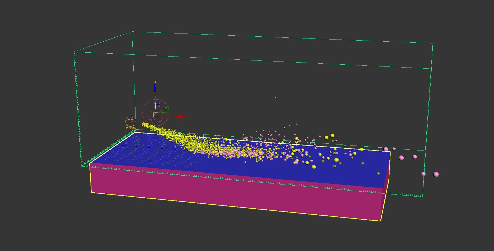

I'm trying to make a simple flamethrower effect, where tyflow emits the particles and then use Phoenix to run the sim.
I have set the simple emission (image attached), but nothing happens when I run the sim. I keep seeing the particles but no sim.
Can someone please tell me what is the right workflow to achieve the effect I'm trying to make?

Thanks man, that solved part of the problem. Now I can see some interaction between TF and PH. I'm saying some, because I still don't know how to add the events 03 and 06. So those particles are not interacting.
Do you know how to specify events to add?

Thanks. I see the particles, the problem is that Phoenix only uses the particles generated by the "event 01" to create fire and ignores the other two.
