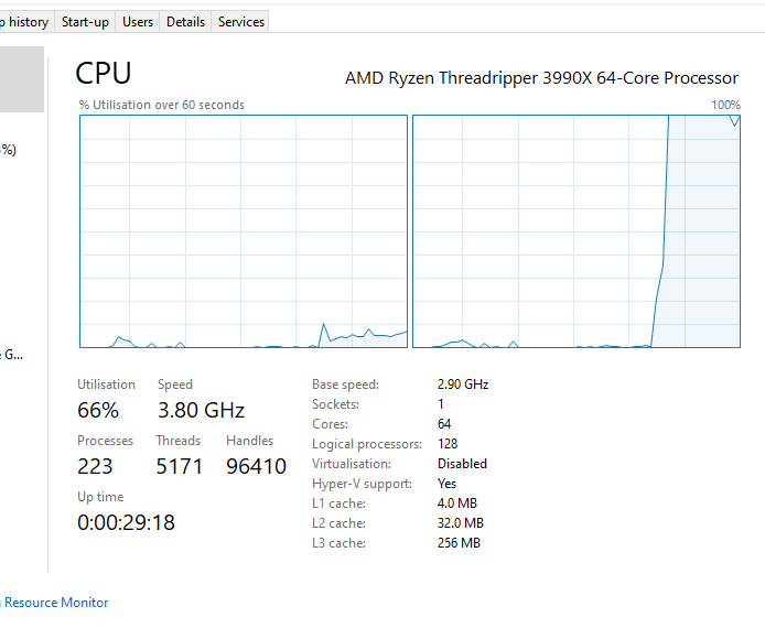

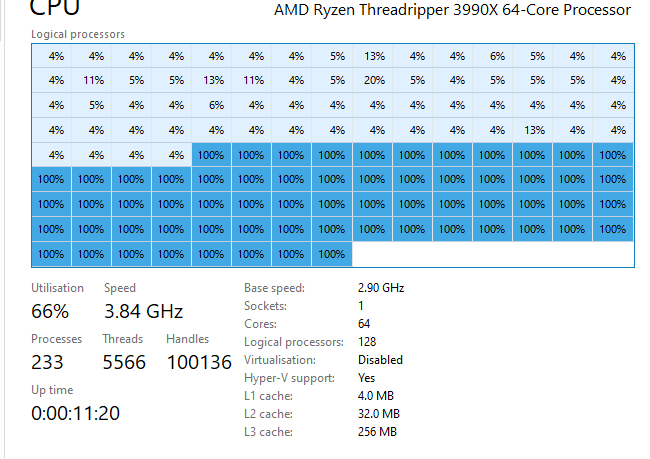

Well I tested again as you suggested, I tried different ways and I always get the same result.   from 1m to 10m  the usage was exactly the same 50% of the threads only at full power.
I tried to duplicate the events, to 20m to see if would grab some of the other thtreads with no luck.
I understand might be a complicated issue, it is not so critical to me either, I will just enjoy my espresso between simulations Smile   just wanted to report it.
I guess the problem has to do with the numa cores one of them is at 100% while the other is calmly resting.
image attached.
RE: 64 thread limit? - tyFlow - 02-29-2020
Ah yea it seems like a NUMA issue.
If you go to the Debugging rollout of a tyFlow object, there is a "Print NUMA Info" button you can press, that will print all detected CPU info to the MAXScript listener. See if that reports 64 detected CPUs or not...
If it prints out 64 CPUs detected, then it looks like it's a windows thread scheduling issue. I create threads for each CPU on a machine, and assign (up to) that many simultaneous tasks, however windows does the actual scheduling itself.
It's possible that if windows is throttling CPUs like that, that you'll get worse performance in tyFlow because of it (ie, because tyFlow may create 64 threads, but they're spread across only 32 cores). Try loading up a really slow simulation that uses all 32 cores, and in the tyFlow main settings set max threads to 32 and see if it runs any faster....
Also check the CPU affinity of 3dsmax.exe in the windows task manager and make sure it's assigned to all 64 cores.
