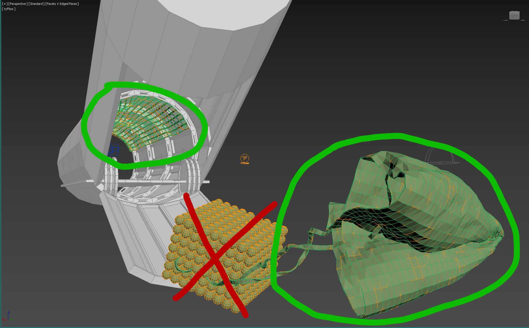

I exported a tycache of my sim, i now use typarticleskin to attach my crate to the sim.
I want to hide the spheres (voxels) needed to run the sim properly. How to do that?
I been fiddling around way too long so things get more and more confusing here now...

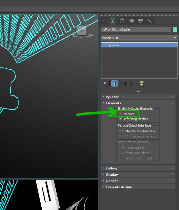

I turn off display in the event, but its still there when i cache it out
Unchecked this (image) and then something happened. Think i got the result im after now Smile
RE: Hide part of cached sim - tyFlow - 12-29-2020
Particles will still be exported even if they don't have a Display operator active.
To prevent export of certain particles you can either use Export Groups to define which particles will be exported, or place your Export Particles operator in a certain event to only export the particles in that event. Or you can disable particle export entirely in the Export Particles operator...it will still export skins if you have skin export enabled in the settings.
