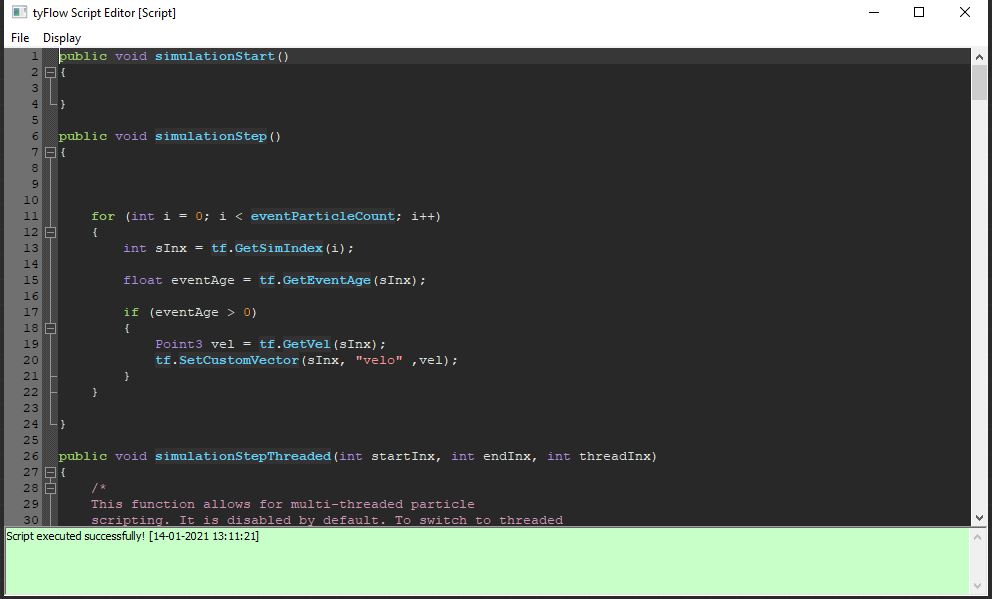

getting wrong velocity values from custom vector - apratim_appie - 01-14-2021 Hi, I think there is an issue regarding velocity data when "physx shape" operator is present in the flow. Here I am simply putting the velocity values in a custom vector but it is showing me the wrong values when displayed through display data operator. I am attaching 2 screenshots to clarify the statement. Please look into it. Thanks. RE: getting wrong velocity values from custom vector - tyFlow - 01-14-2021 That's the correct behavior. Script operator evaluates before PhysX, Display Data shows you the final result after PhysX. The PhysX solver can modify particle velocities, so a different value is expected. RE: getting wrong velocity values from custom vector - apratim_appie - 01-14-2021 (01-14-2021, 07:57 AM)tyFlow Wrote: That's the correct behavior. Ok great, I didn't know that. Thankyou |
