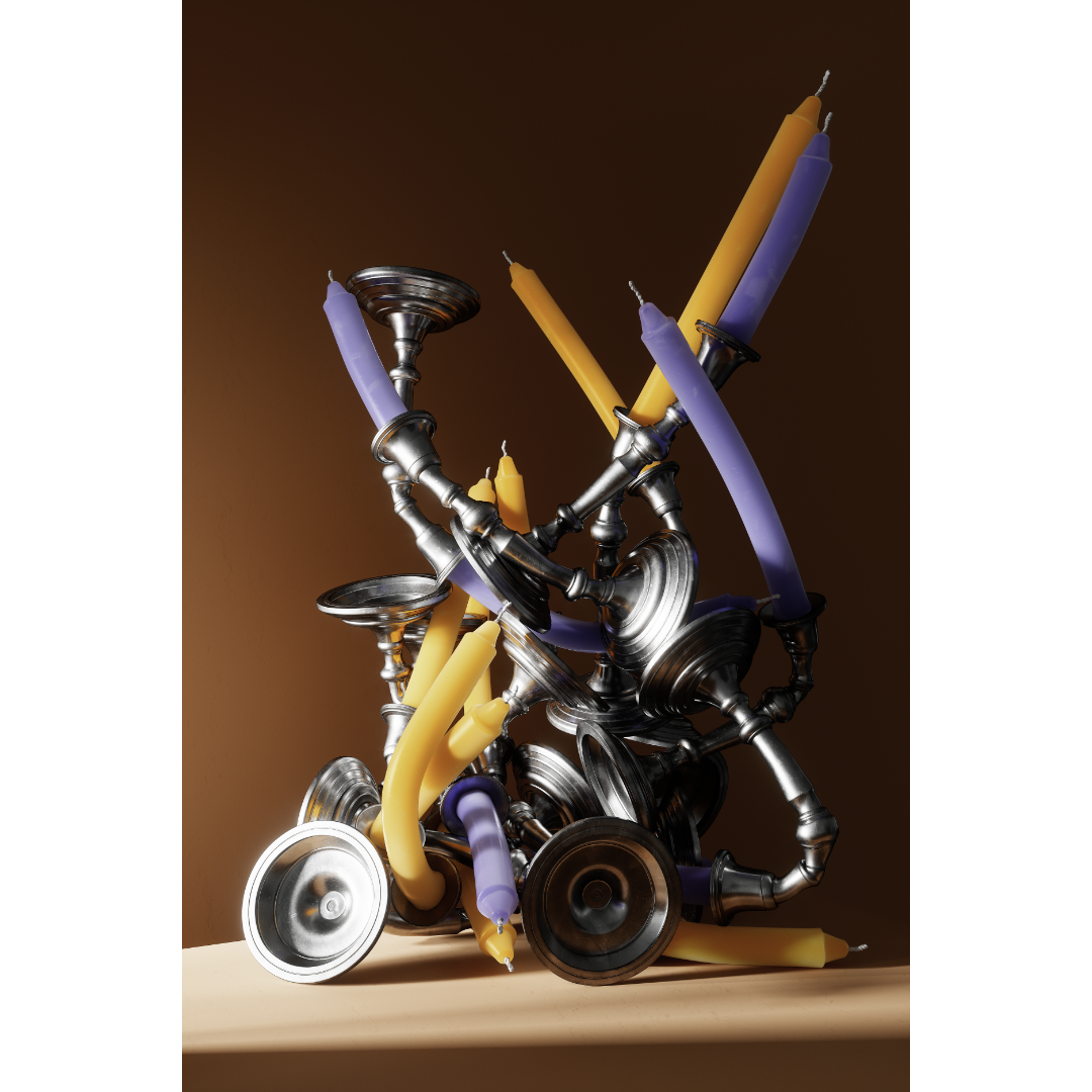

RE: Particles shape variations with tyParticleSkin - ffantom - 02-18-2021
Perfect, I've done it like this: final render in attachment. Thank you for advices!
RE: Particles shape variations with tyParticleSkin - tyFlow - 02-18-2021
Great! I'm glad you found a workable solution Smile
