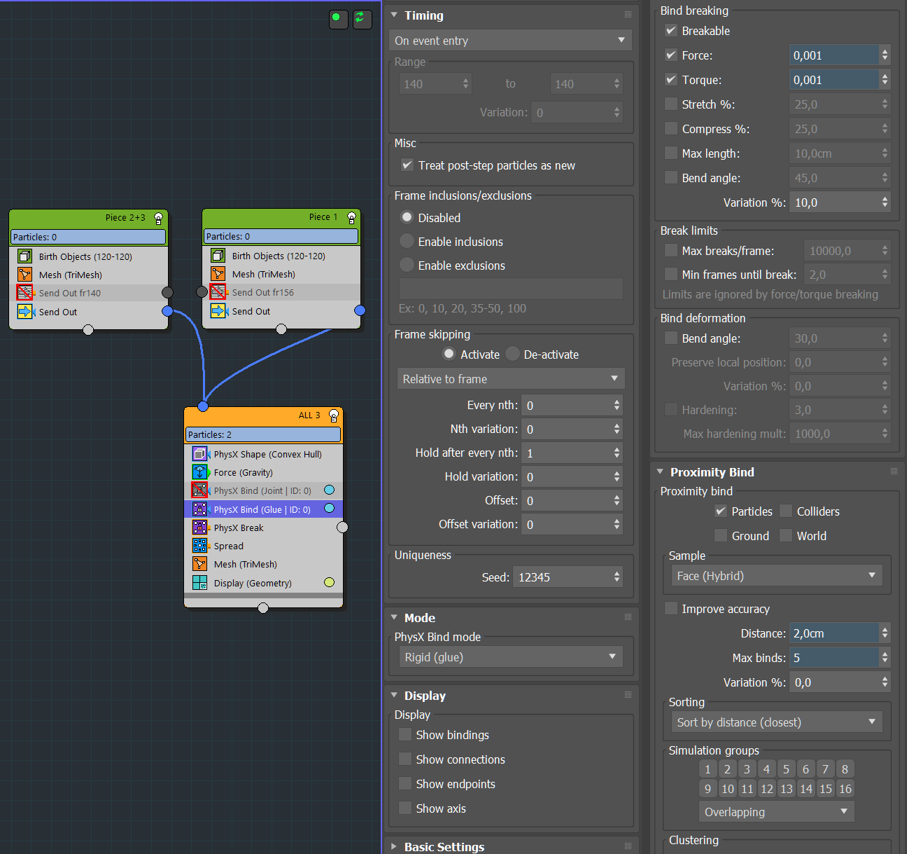

PhysX Break - not breaking - Alexx31 - 08-28-2023 Hello, I have something to break, which isn't breaking. Testing for an hour now.... Values are extreme low, and no matter over how many frames the gravity is working. I have even added a spread (outwards), which is spreading but also not helping to break. What could be the reason? I would expect when enabling "breal ALL" that it really breaks all. (When I disable physX bind it immediately breaks.) Many thanks RE: PhysX Break - not breaking - tyFlow - 08-28-2023 Can you post the file? |
