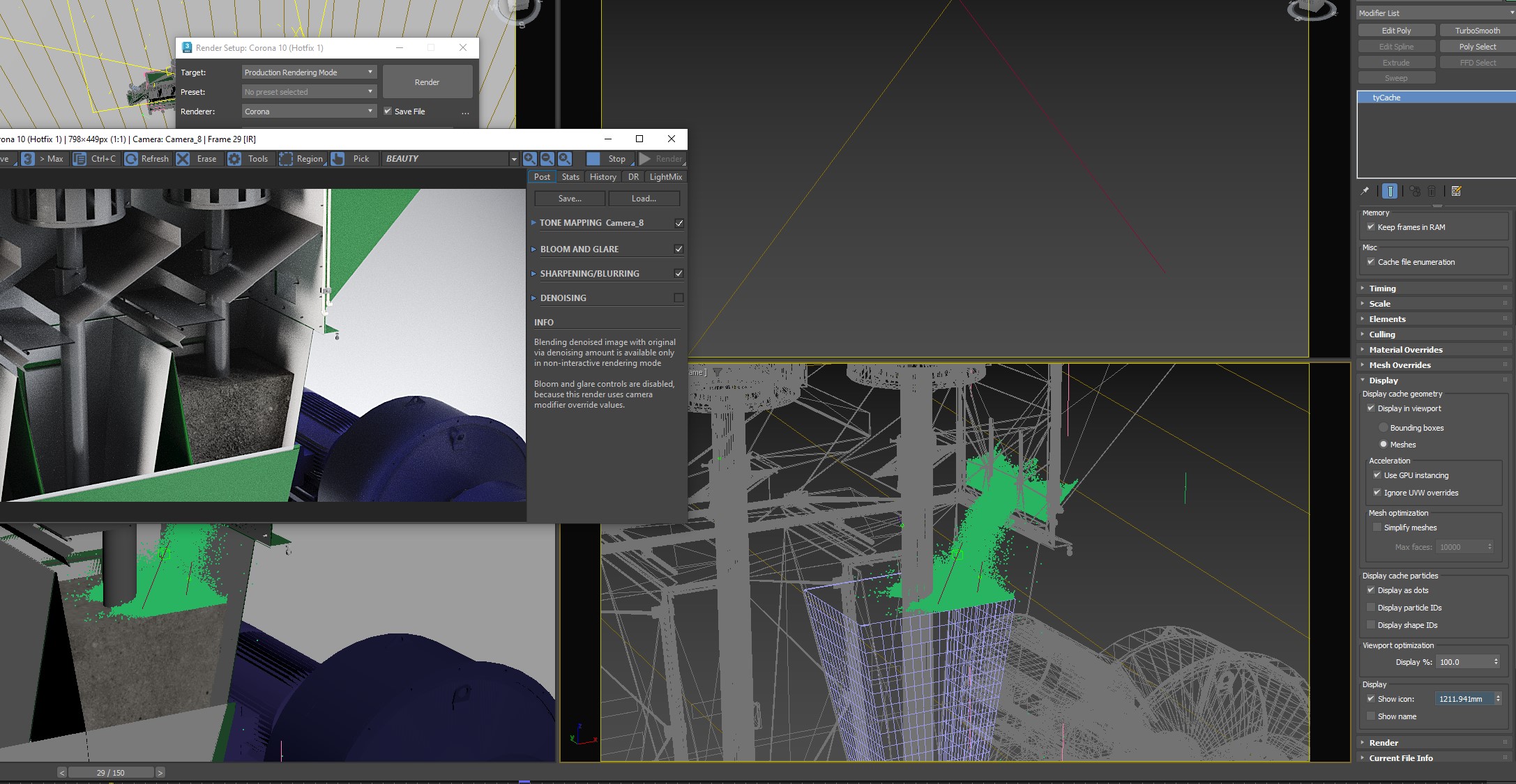

Hi all,
Tycache is not loading my mesh properly. I know it is there as when i check 'display as dots' it shows it, when unchecked it disappears. Has anyone else had this issue?
Cheers

I used the 'export particles' operator to export the .tyc files. Then i used them to add back into the tycache, but it appears ive missed somthing? I need to export a mesh also? is this an operator?
Thanks,

Sorted. You were indeed correct.
I had moved all the part.tyc files to our server but i hadn't moved the single mesh file that it creates.
