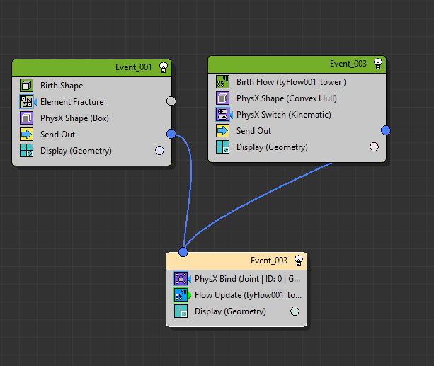

I have a fairly complicated flow using multiple birth shapes, voronoi fractures, physx bindings and dynamics, etc. This is all working pretty much how I want, but now I need to "attach" smaller detail objects to the existing simmed geo without it affecting the current sim. I've tried creating a new flow with a birth shape to turn the detail geo into particles and choosing the original TyFlow object in an Object Bind operator, but it doesn't seem to work. I've also tried using a Particle Bind in the original flow instead, but I need these smaller bits to follow the closest SURFACE of the simmed geo, not simply their particle center points.
I was wondering if there might be a way to add these smaller objects to the PhysXBind but have them ignored for mass and collisions, etc. Think of a bridge collapsing where all of the major structure is simmed but you want to attach extra "gak" like braces and bolts to that.  Thanks.

If you want to import particles from one flow into another, use 'Birth Flow' and 'Update Flow' to keep them in lock step, not Birth Shape. Then set the imported particles as kinematic using a PhysX Switch and attach your detail particles to them with PhysX Binds.
RE: Attach particles to surface of physX simmed geo? - mitchfx - 04-27-2019
Thanks Tyson!  It took some more trail and error but I think I have the correct setup now (see screenshot).  Trying to have the Bind op in either Birth event wasn't working so I ended up doing a send out of both to a new event that contains the Flow Update and the Bind.  On a related note, I've been a bit stumped from day one about how the "bind non-sibling" option is supposed to work.  My assumption is that it will allow particles or physx shapes to bind with everything BUT those born in the same event.  However, I cannot ever get it to work at all and when I use this option my bindings simply never happen.  I usually end up using group limits instead, but it would be nice to understand a little more about the non-sibling option since it seems like a more elegant method to do what I want.  Is there any chance it's just not working correctly, or am I simply misunderstanding something?
