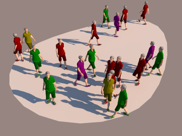

Which Vray textmaps can this interact with? A fairly fundamental part of the randomization will be the character's clothes colours. I was doing this previously with instances using the Corona colour map. It just needs to be a randomised diffuse colour which will then feed in to a composite map. I've tried all modes on the VrayMultiSubTex and they all produce a single colour or by face ID (as in the image below).

Hey,
Currently Instance IDs only apply to VRay Instance particles. Actor skinned mesh particles are not treated as instances and thus the Instance ID settings will have no effect.
Quote:Do I need to need to combine all those materials into one mega multisub material and just keep track of the materials
Unfortunately this is currently your only option, due to some limitations in the way max handles meshes internally. If you check the roadmap you can see that better actor material randomization is on the todo.
