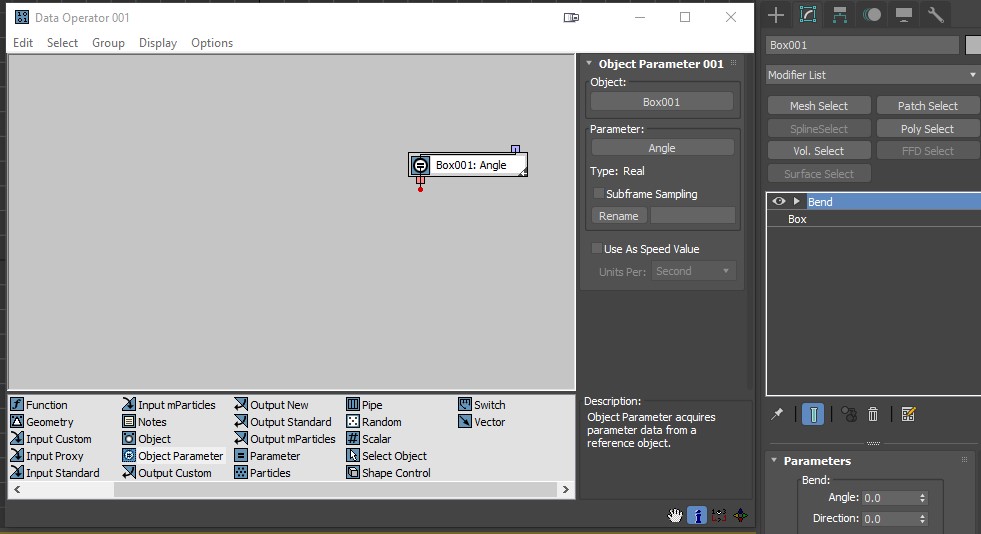

the idea is we want to drive value with another value that we prepared beforehand. its the same concept as data operator in PFLOW.
there is "object parameter" which does the same (see attached image). i can acces bend angle value to be use for anything. the value doesn't have to be matrix...it can be float,vector,boolean,etc.
and it doesn't have to be implemented in "birth" operator. as along it can acquire data doesn't matter where you gonna implement it. just plug it to be used in other operator. for example set position from attribute/parameter. or any other use case. its quite flexible actually (just my opinion).  Smile
