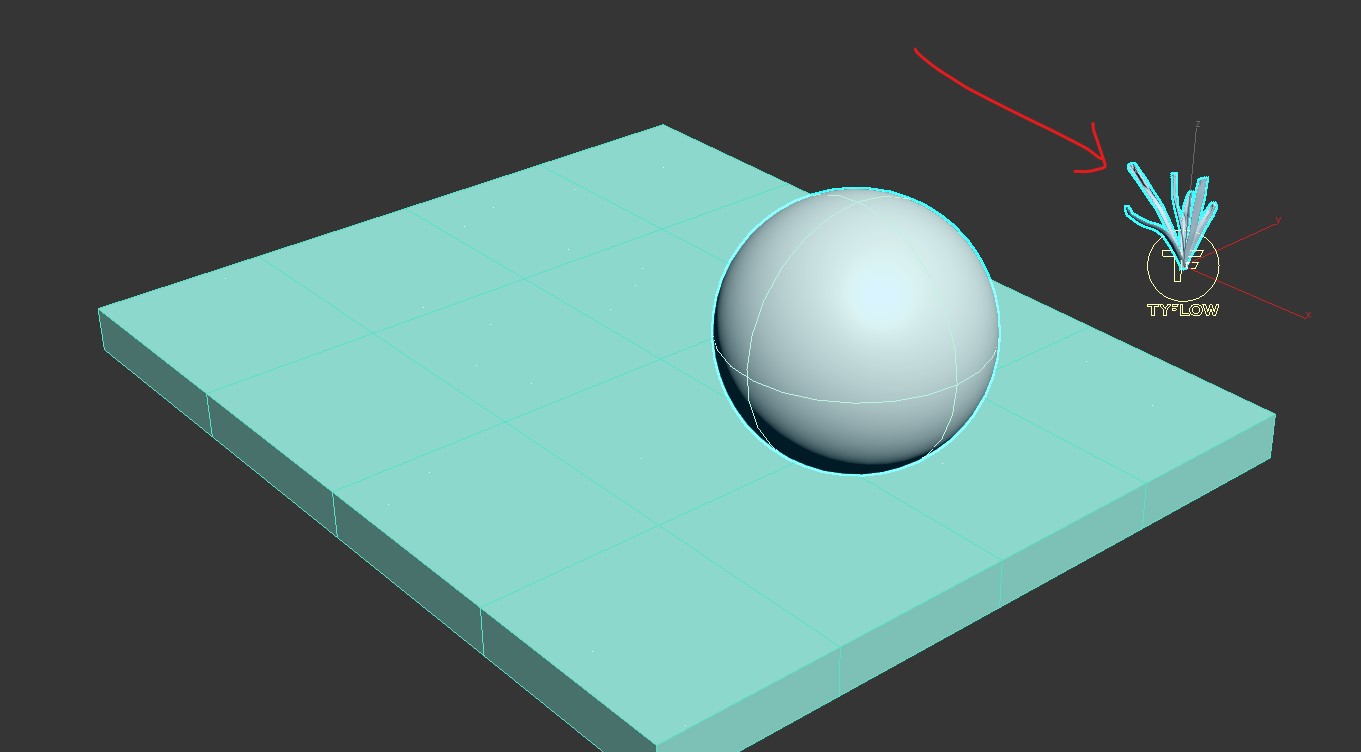

In the shaded view i can't see the objects properly scattered they appear in the Tyflow Logo.

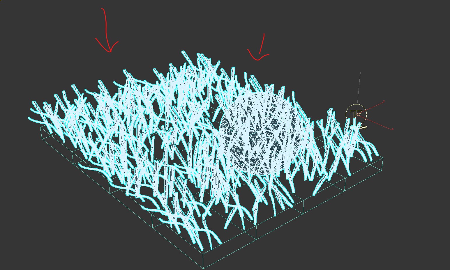

But if i switch to wireframe the objects appear in place.

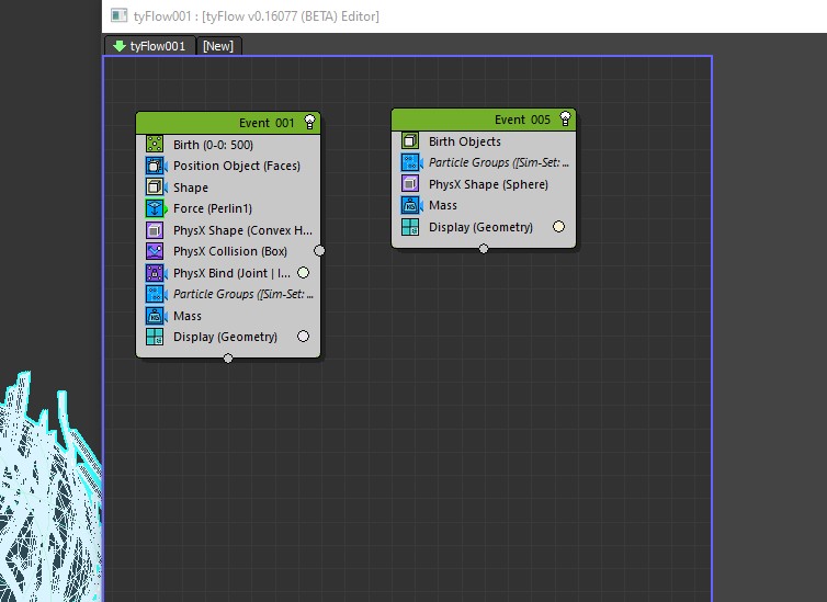

Not fancy stuff going on I'll share some screenshots.

I've never seen that problem before and it technically shouldn't even be possible. Looks like it could be a driver issue and when I send transforms to the GPU the GPU isn't interpreting them properly.
Can you make sure your GPU drivers are up to date?
If you manage to cause the problem in a reproducible fashion in a particular scene, could you please upload that as well.
