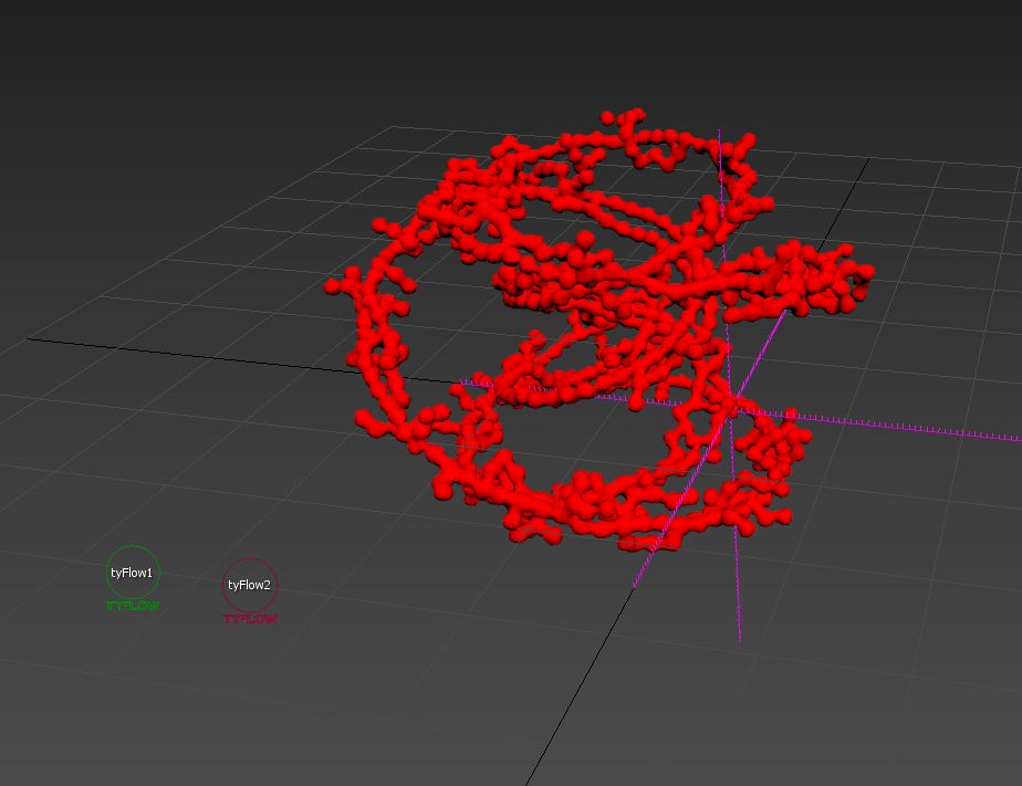

1).-A Tyflow1 with mapped uvw particles (AS IMG1)

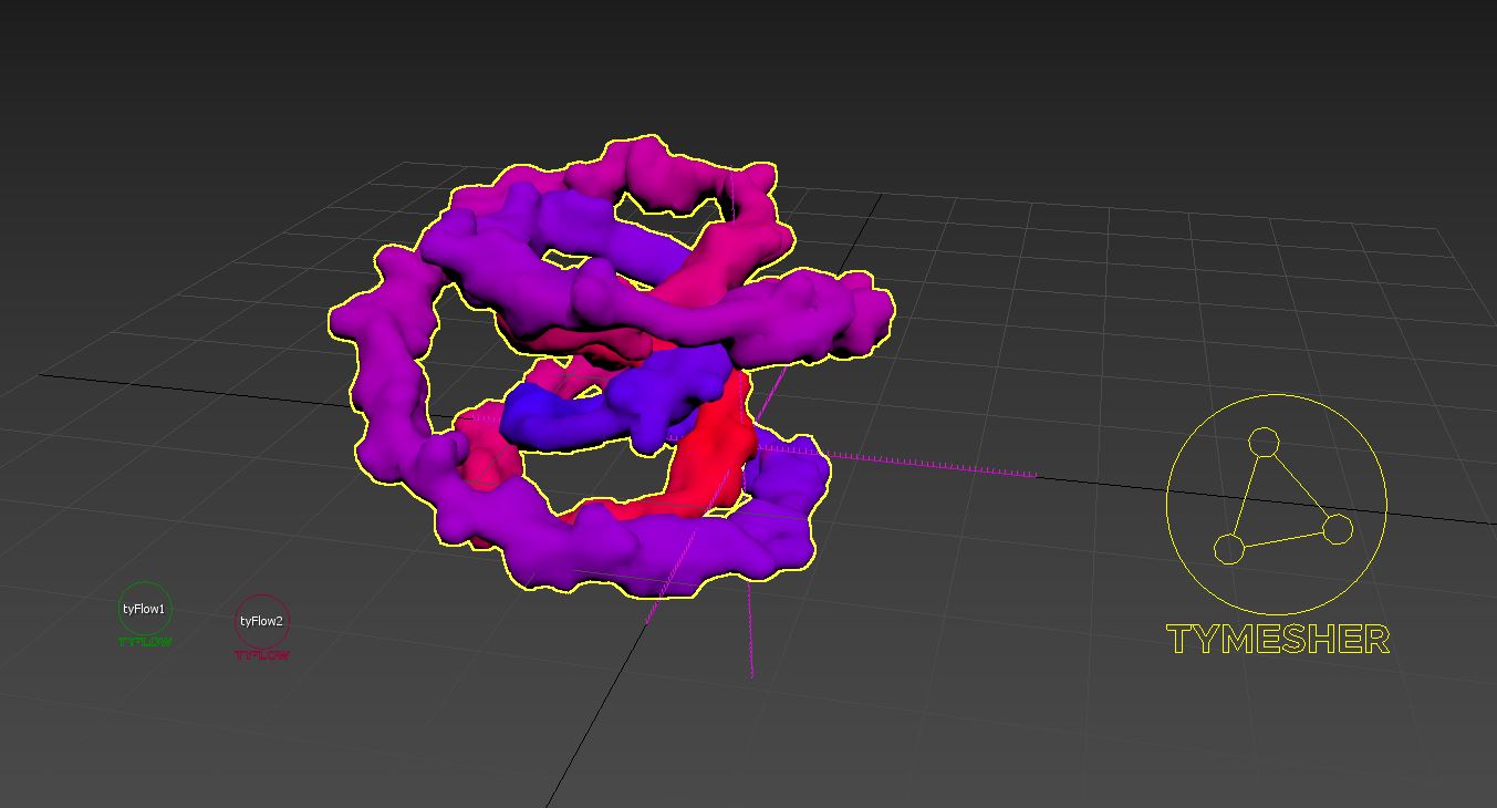

2).-A Tyflow2 using Particles to SDF and VDB Modify (UVW = Particle UVW) (AS IMG2)
ISSUE:
-Tyflow2 does not get the correct UVWs
-Tyflow2 VDB Modify (UVW=Particle UVW) rollout in Particles Section->Include this flow's particles cant pick, Add Selected, Remove

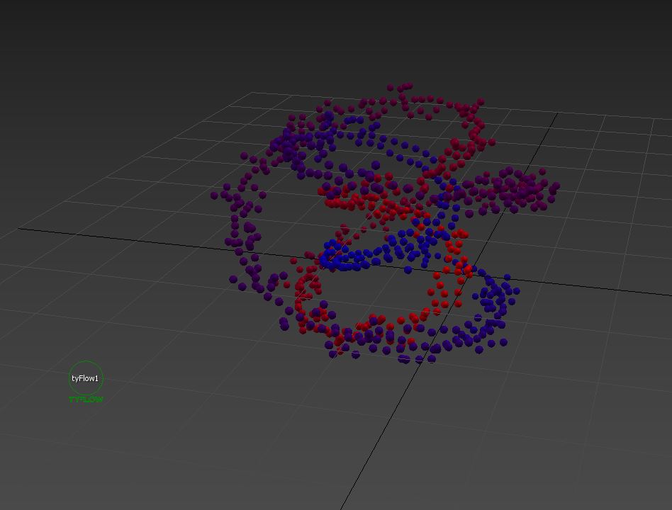

A TyMesher applied to Tyflow1 Shows the correct uvs and mapped colors. (AS IMG3)
