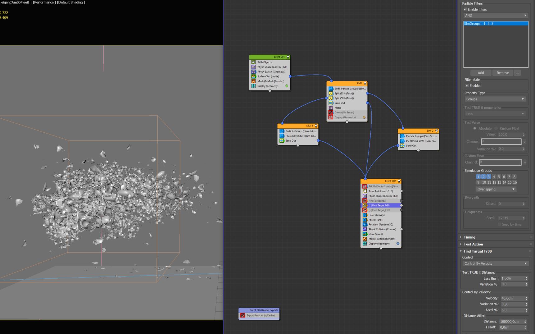

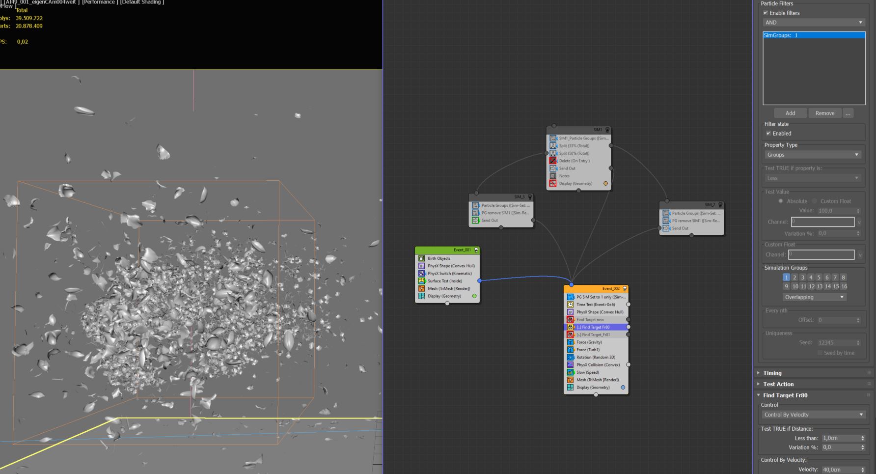

I have a scene, where I want to split the flow randomly into three SIM-groups (1,2,3)
and I spent again 2 hours trying to understand the unpredictabe behaviour of SIM groups
So now I have a logical problem, that the simulation differs extremely, when doing exactly the same with using SIM groups or doing just the same without them.
In the scene is only a "Find Target" Operators with Filtering enabled or disabled for SIM groups, and all3 setups should give the same result, but they look very different:
- the first is my simulation without any usage of sim groups
- the second screenshot is my simulation setting the flow to SIM1 and enable Filter for SIM 1 (which is everything in the flow)
and should not change anything, because like before everything is addressed
- the third screenshot is my (original) setup, where I wanted to split the flow randomly into three SIM groups 1,2 and 3.
And again it looks even more different, despite it is the same flow with everything.
What's here the reason?
Thanks for explanation!
