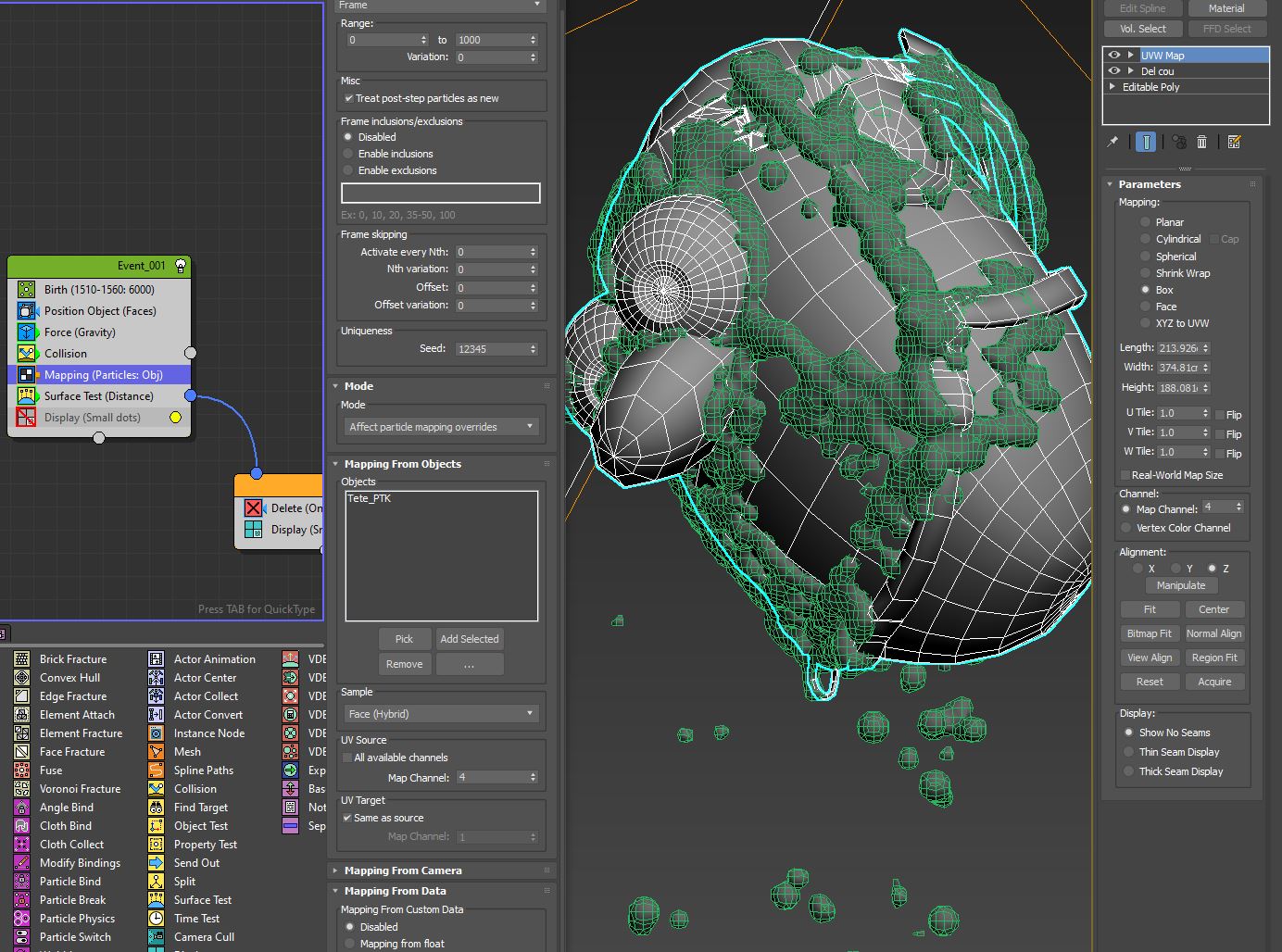

I want to pour cement on an animated head.
Hom to map the particule ?
I used a mapping node but no matter wich box is checked, the map remains sticked to the word and slide on the particles.
What am I missing ?
(Max 2017 + TF 0.16102 + Win10)
Well your Mapping operator timing is set to Frame 0-1000, so it's updating every frame...hence the sliding.

ooops no! I spoke too fast...
it still doesn't work even with timing set to Frame 0-0 or another frame in the sequence.
