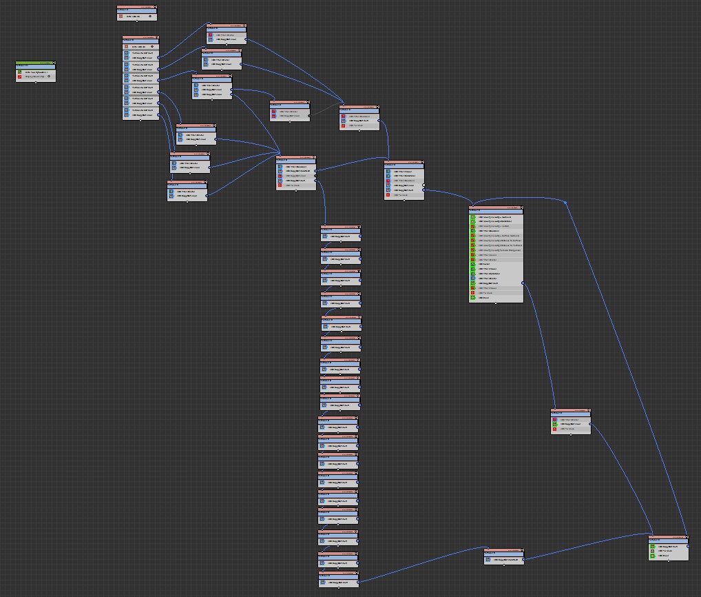

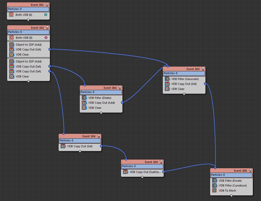

For instance I'd like to patch a flow like this:
that behave like this:
Here's how some of my flows look like if I want a substraction to be evaluated in the right order Sad

As for your event ordering...events are evaluated breadth-first, top to bottom. So yea...things can get tricky when you need them to evaluate in a different order due to where/when you're sending data between events.
I'll add a setting in the next build so that you can offset evaluation for any event, not merely birth events. Maybe also an "evaluation order display" or something so no guesswork is involved when specifying order values.
