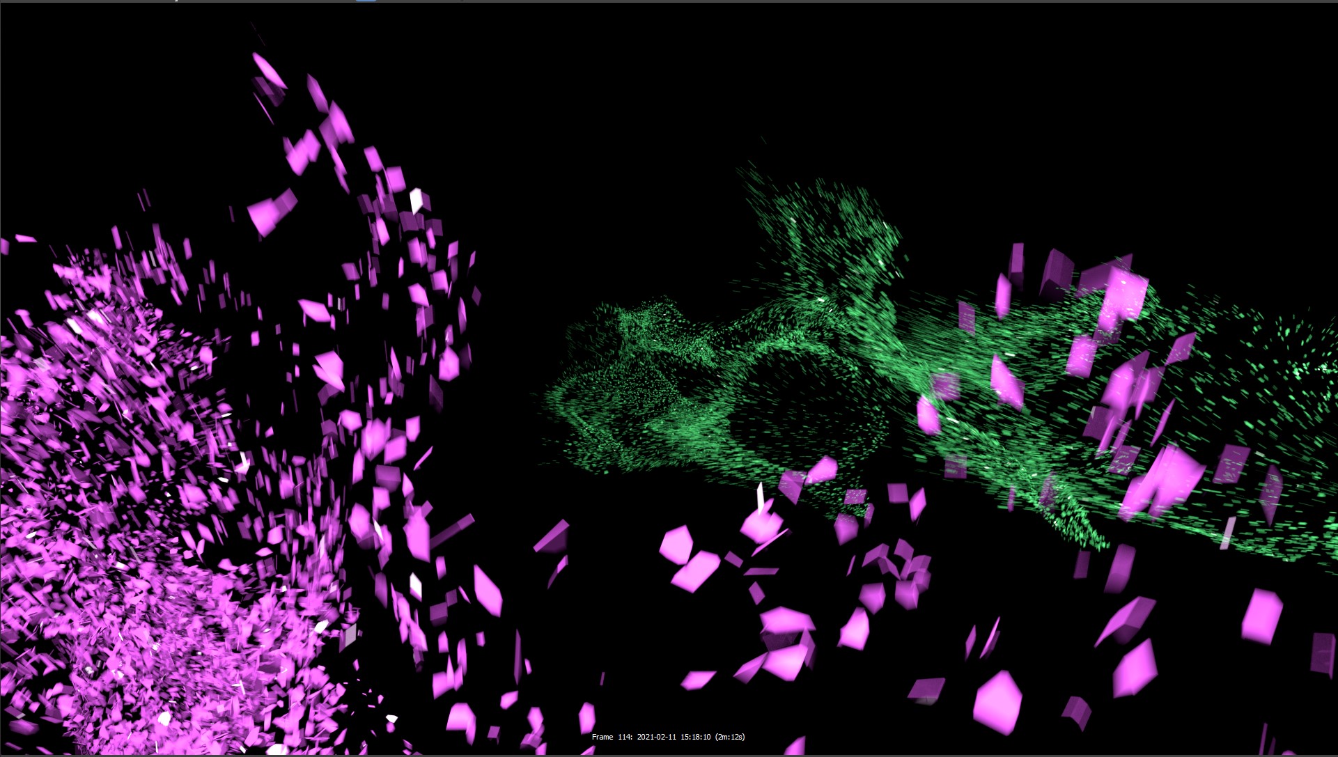

I don't understand the reply from the RS devs, because when rendering as instances the geometry is not being deformed...only transforms are changing. The issue has nothing to do with velocity channels or changing vert counts. Each instance assigned to a particle is a static mesh with no mesh-based velocity information. Note: there are exceptions to this rule that apply to cloth/actor rendering, where instances will have deformation information...but that doesn't apply in this case.
When the particle interface is enabled and all Mesh operators are set to instances, I get a decent render time and the moblur looks fine.
If RS is giving you an error about topology and/or deformations, that means your settings are not correct and you're not rendering as instances. Or you're not rendering with a compatible version of RS.
In any case, the emitter size is irrelevant. Perhaps you're misinterpreting an error about the changing topo of your sliced emitter, as a tyFlow problem.
Attached is what I see when rendering with the latest RS, with the particle interface of both flows enabled and all Mesh operators set to render as instances. As you can see, moblur renders correctly.

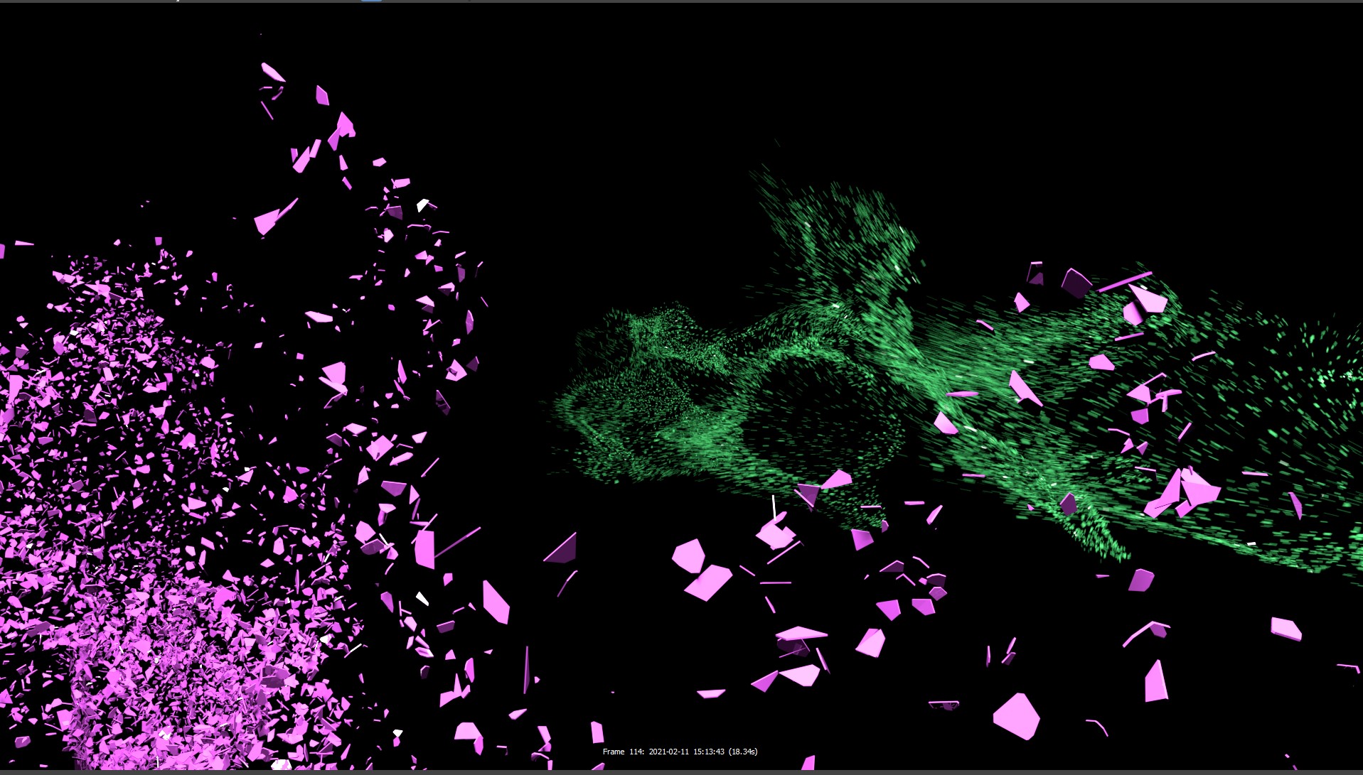

Yes, in our case in the test scene, with the particle interface enabled, the render time was also decent (132 sec, as I wrote above). But in the working scene, the rendering of one frame takes more than 33 minutes, which is inappropriate, and without the particle interface enabled, the rendering time is 27 seconds.
The question that we are trying to clarify is the possibility of rendering a frame with MB without the particle interface enabled.

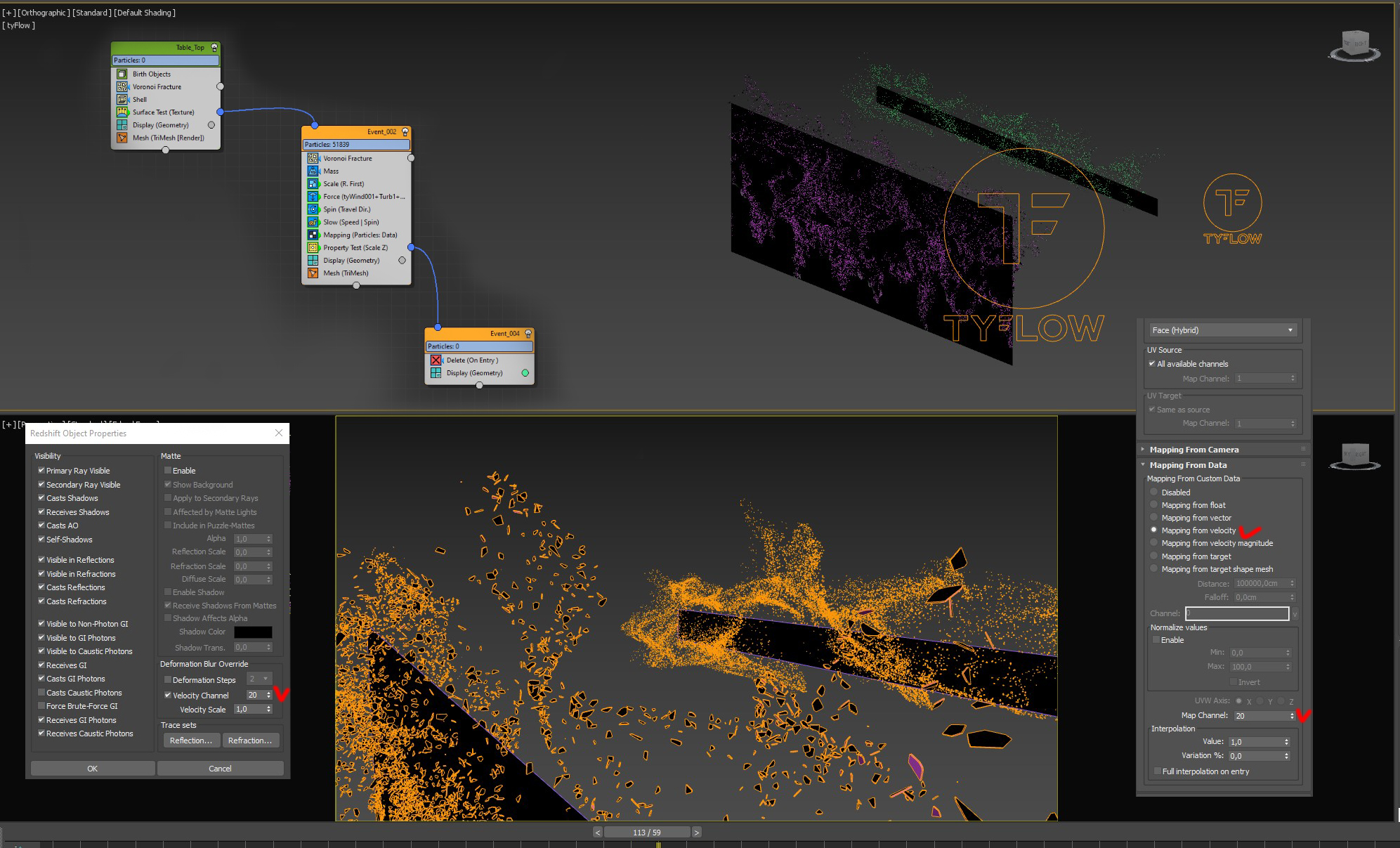

There is a mode: we write Velocity data in Channel 20 via the Mapping operator, and then in Redshift Object Properties we specify Velocity Channel 20 as well. In this mode, MB is also computed, but not stably, selectively - some of the particles are computed without MB. The question is how to stabilize this process that without the particle interface enabled, MB is computed stable and always, because it is much faster way.

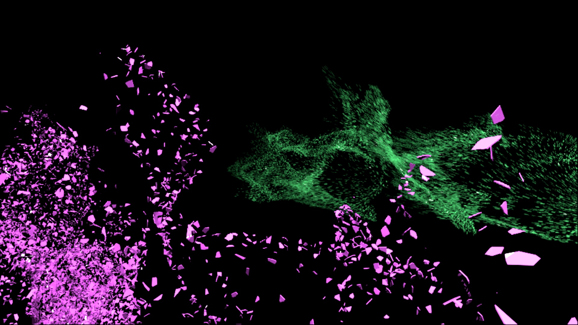

Ok so if I understand correctly,
1) if you render using the particle interface/instances, RS will render with moblur but it takes a long time
2) if you render as meshes, RS is much faster but it won't render with moblur
3) if you render as meshes using the map channel 20 workaround, you get a fast render with moblur but it's not consistent across all frames

Why (3) is not working is more curious. If RS is indeed using the mapping data to calculate moblur, then topological changes should no longer matter because it's not sampling points in time to figure out geometry deformations, instead it should just be implicitly moving vertices along the velocity values in the mapping channel. Perhaps, due to the fact that this velocity/mapping workflow is somewhat of a workaround, they have an internal switch that is still activating when topology changes are detected, even though for your use case such a switch could be ignored because topo changes wouldn't matter.
Either way, tyFlow seems to be doing all it can to get vel data to RS. The remaining issues seem to be things that need to be sorted out by RS.
If you really want to dig in, once you assign your mapping values to particles and convert them to a mesh with a Mesh operator, you can use MAXScript to query the mapping values of particular faces and such...just to be sure the geometry is getting the correct velocities values assigned to the map channel of your choice. Also since RS has a spinner which allows you to define which mapping channel will contain the velocity data, you could set that to whatever channel you want - doesn't necessarily have to be 20, that's just what tyFlow uses internally. Make sure the channel matches whatever you set in your Mapping operator as well.
