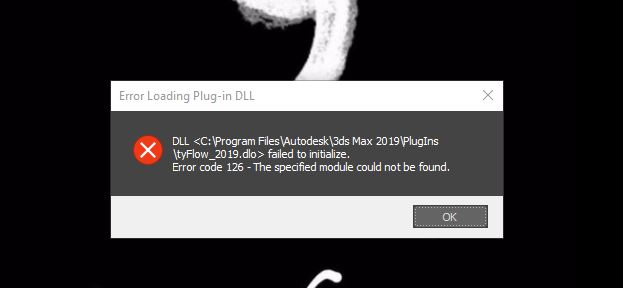

Crash on startup: "the specified module could not be found"
Currently looking into this....
same problem with 3ds max 2018
not a very cool April Fools joke.. ;p (same 2018 error)
BTW, this forum shows up as not secure in chrome. Concerning?
I have an error with 2019
I use Octane Render
I got the same error when adding tyflow2019 to 3dMax 2019 plugins folder:
Error Loading Plug-in DLL
DLL <C:\Program Files\Autodesk\3ds Max 2019\plugins\tyFlow_2019.dlo> failed to initialize.
Error code 126 - The specified module could not be found.
But the 2020 plugin worked with 3ds max 2020 tho.
Here's a new build that I believe solves the missing module error:
http://apps.tysonibele.com/tyflow/beta/D...019_016002
It's just a 2019 fix for now...let me know if it works for you!

I pushed new builds for all versions a few minutes ago....can you let me know if the 2017 one works for you?

Hey Tyson,
Max 2018 is loading without error now. Thanks!
#11
Great to hear! I've had similar reports from all others who've tried the latest version, so I'm considering this bug fixed.

http://apps.tysonibele.com/tyflow/beta/D...low_016002
I was able to start without an error.
Thank you for the great plugin.
I am looking forward to the release.
Smile
#13
I have "Error code 126" with the 003, but work fine with the 002 (max 2019)
#14
Hey Alminia,
Are you on Windows 7?
I just realized the code I implemented to fix the 4K DPI issue is only on Win8.1 and above so it'll produce the error you got...working on a fix right now.
#15
tyFlow_016003 max 2020 same error....tyFlow_016002 max 2020 works fine....windows 7....
#16
Yup sorry about that, I'll have a fix up in a minute....it's a Windows 7 problem.
#17
fastest response ever ! thanks tyson ! waiting patiently...:-)
#18
Hey, could you try this version on your Win7 machines and let me know if it boots up? Smile
http://apps.tysonibele.com/tyflow/beta/D...low_016004
#19
works like a charm ! thanks tyson for being so dedicated ! amazing experience !
(cheers from israel :-) )
