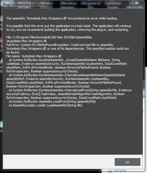

I'm getting errors after I install tyflow, just wondering if this has been seen by anyone else.  Have no issues with any other plugin I have but as soon as I drop tyflow into the plugins folder and open max, the dll errors pop up.  I can still click past these errors and use tyflow but if I right click on objects to get to the object properties, another error pops up.  So making max not fully functional.
When I delete tyflow from the plugins folder, all goes back to normal and everything works as expected.  I've been trying to figure it out for days. I see posts online saying could be user prefs but forcing new user prefs has no effect.  There were a few other things I tried but nothing worked.  The most extreme fix is to clean uninstall max and reinstall.  Before I do that I wanted to check here because like I said, never had any issue in max until tyflow.  So if there's a bug or something within tyflow that is causing this to occur, I don't want to go through the hassle of clean installing for no reason.

Sorry to hear you're still having these issues. Unfortunately, they're being triggered after tyFlow is initialized so whatever is causing them is not something I can debug directly. Autodesk developers themselves would have to chime in.

Just another update. I was able to finally get tyflow to play nice with my machine. I kept glossing over one of the Autodesk solutions til last night. Basically the solution in my case was to add 3ds max to the windows environment variable. I really know nothing about how or why it works but looks like from the max errors, Windows could not find either Autodesk.Max.Wrappers.dll and SlateSdkWrapper.dll. But this only happens after I place the tyflow dll in plugins. If I remove it, Max is fine. Seems related to tyflow in some way seeing how the dll is what triggers the message. Thought I'd update in case other run into this.
Seems to be working fine now, no errors on startup and my right click menu in Max no longer gives my an error.
Here was the solution that did it for me. Add a System Variable:
https://knowledge.autodesk.com/support/3...s-Max.html

This problem is actually fixed in the next build (v0.16017). So, soon there won't be a need for the system path shenanigans.

We are using version 016055 and are having the same issue.
I tried the variable change, we reinstalled 3dsmax and we are still running into the issue on some render nodes of our farm.

Create an empty file called "c:\noOpenCL.tyf" and see if the machines boot up....

Thanks so much for your help that did the trick!
So is disabling openCl not a big deal if it's just on our render farm?
We are curious to know what this does exactly? Should we do it on all of our farm computers even the ones which don't have the error?

If Max is actually crashing while trying to initialize OpenCL, that usually means you've got bad OpenCL drivers on the machines. I'd suggest upgrading the GPU drivers on all crashing machines and also read the FAQ about removing bad drivers in the max root directory:
http://docs.tyflow.com/faq/performance/
tyFlow will still run without OpenCL acceleration, it just means the bind solver (Cloth/Particle Bind/Particle Physics) will run a lot slower. If it's just farm machines reporting the error, it shouldn't really matter since I'd recommend caching out any flows you plan on rendering anyways before rendering....and caches aren't affected by the GPU acceleration at all.
