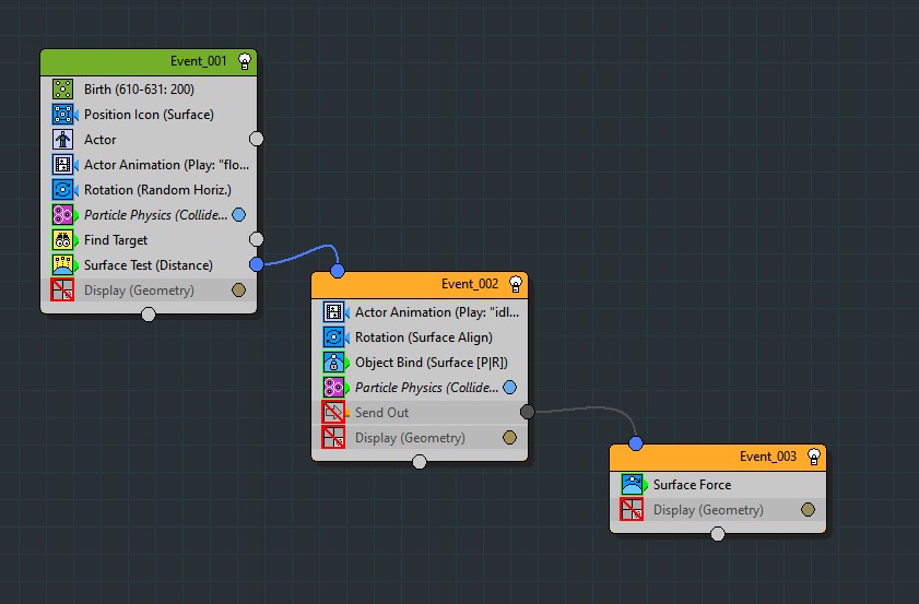

Currently i have particles snapping to the surface of some geo using surface test with distance. Once the particles get near enough they snap very quickly to the geo. Is there a way to make this a smooth transition?

Yes it's slowly rotating. It is a miniture planet and a few hundred actors get scattered by a large god like character on to the planet being attraced by a find target.
Hmm...moving object is going to be trickier.
Why not just make the Find Target/Surface Test distance small enough so that when the snap occurs it's not perceptible?
(03-08-2023, 04:21 PM)tyFlow Wrote: Hmm...moving object is going to be trickier.
Yeah there are workarounds, but sometimes with their speed, some get missed so i made the radius more so they get picked up. it's fine just wanted to know if there was a way to do it. i was messing around with custom properties but it's good to know i don't need to waste my time trying stuff. thanks!
I figured it was something like that (larger test radius to avoid missing particles).
When they're within range you could send them to a second Find Target event (using 'by time') to force them to move towards the surface without worrying about them overshooting.
