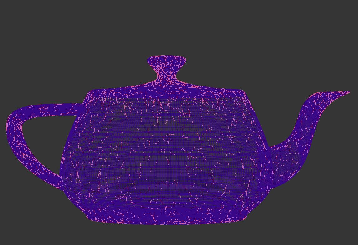

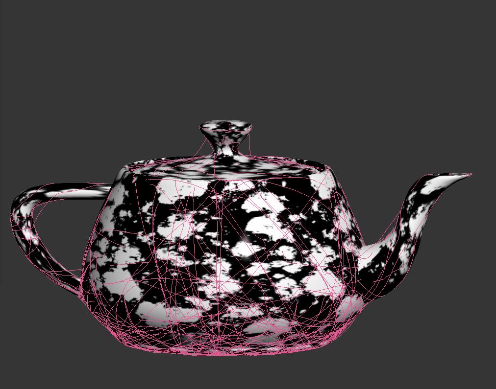

I'm just playing around with spawning particles on a teapot making them flow around its surface and then adding from their movements. I'm using a b/w bitmap to control the flow.
I'm wondering if there any way to use the same bitmap to control the spawn location (say only the black areas) and have the particles flow only on those.
I'm using the gradient ascent and gradient trace in the surface force, and it might be working. However, because it's spawning all over, I can't tell.

Use a Position Object operator and set the density to be controlled by texmap...drag in your map and it should work Smile
Gradient ascent/trace won't work with pure blacks/whites. It's basically forming a UV-space vector by examining color value differences in a small sampling of texture points. Imagine your bitmap used as a displacement map on a mesh...the gradient modes are basically trying to find the direction of a slope created by your bitmap. Pure black/white areas have no slope and thus won't return a meaningful vector.
