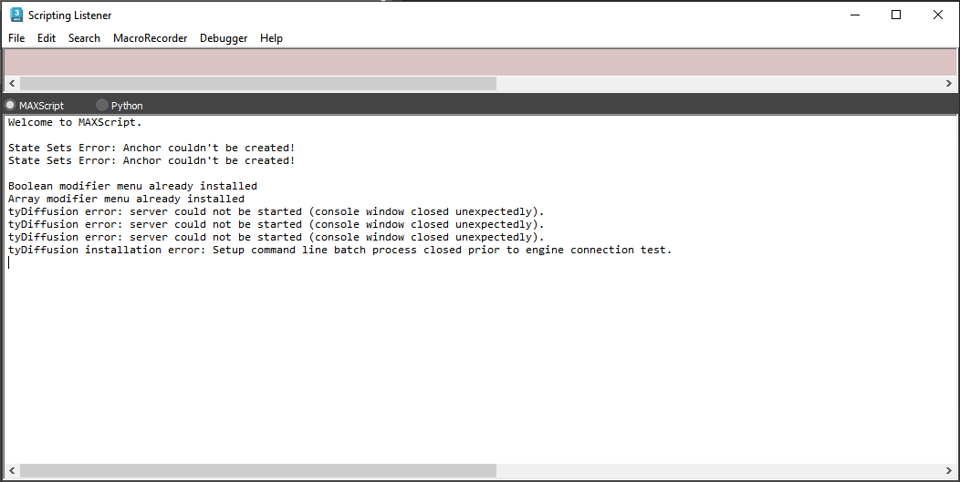

I got an error while installing the tyDiffusion One-click install:
tyDiffusion error: server could not be started (console window closed unexpectedly).
tyDiffusion installation error: Setup command line batch process closed prior to engine connection test.

I am using the latest 3ds max 2023 Version and did install TyFlow pro 1.111. Tyflow Update is running fine and license is activated but I cannot see the tyDiffusion menue selection at the bottom of the viewport shading menues. Tried different scenes. Is ther eanything I am missiong out? Please help, thank you.
(07-03-2024, 05:04 AM)keithwmg Wrote: I got an error while installing the tyDiffusion One-click install:
Me too, using TyFlow free on 3dsMax 2023, and I can see it tries five times to use python I guess
C:\****\tyDiffusion\Tools\python>python get-pip.py
WARNING: Retrying (Retry(total=4, connect=None, read=None, redirect=None, status=None)) after connection broken by 'SSLError(SSLCertVerificationError(1, '[SSL: CERTIFICATE_VERIFY_FAILED] certificate verify failed: self signed certificate in certificate chain (_ssl.c:997)'))': /simple/pip/
It's the same for you?
Then a lot of white text and same red text speeding and it closes, saying "installation Failed, check maxscript ecc."

One step further: I got tyDiffusion to be installed but when "generating" I all seems to go weel but there is no" view result" selection so I cannot see/get an image result.  When checking in the python promt window I am getting this error: "json.decoder.JSONDecodeError: Expecting property name enclosed in double quotes: line 44 column 15 (char 24745)".....so it seems to be hanging here.
Upate for anybody with the same problem: it´s a know bug (on machines that do use commas in stead of peroiod for floating point numbers), there will be a fix laters today. Workaround is to change machine´s number dispaly to periods instead commas. Thanks Tyson for the fast clearance on this.
#11
The JSON parsing error will happen on machines using a comma in floating point numbers instead of a period (ex: 5,000 instead of 5.000). The official fix will be posted later today, but the temporary workaround is to switch your number display to periods for now.
#12
If you redownload the latest build, the JSON parsing issue should be fixed.

Hello Tyflow and all,
I was experiencing the same issues as above and have downloaded the latest 7/03 build to see if it cleared my issue.
The issues I ran into:
A: (resolved)
This was resolved by turning off my VPN.
B: (not resolved)
none of the safetensor files will download. Image attached.
- No errors in listener

Hi, I have the same error as someone else did above:
I'm not running a VPN. Anything else I can try?

Hi, thanks for your reply. I've got latest 1.112. Run it on a clean empty folder. Still same error ((tyDiffusion error: server could not be started (console window closed unexpectedly).
tyDiffusion installation error: Setup command line batch process closed prior to engine connection test.)) BTW I have previously already had comfyui running ok from before. RTX 4090
I have attached logs and also run the bat as you suggested - the error at the bottom is this:
Code:
(__VIRTUAL_PROMPT__) J:\TyflowStableDiffusion\Engines\ComfyUI\ComfyUI>"J:\TyflowStableDiffusion\Tools/python/python.exe" main.py --cpu
Traceback (most recent call last):
  File "J:\TyflowStableDiffusion\Engines\ComfyUI\ComfyUI\main.py", line 73, in <module>
    import comfy.utils
  File "J:\TyflowStableDiffusion\Engines\ComfyUI\ComfyUI\comfy\utils.py", line 1, in <module>
    import torch
  File "C:\Users\creat\AppData\Roaming\Python\Python310\site-packages\torch\__init__.py", line 235, in <module>
    from torch._C import *  # noqa: F403
ImportError: DLL load failed while importing _C: The specified module could not be found.
.txt   setup.bat.log.txt (Size: 21.28 KB / Downloads: 207)
.txt   setup_ComfyUI.bat.log.txt (Size: 145.65 KB / Downloads: 971)

Hmm...something funky is going on there...looks like it's using the wrong Python version during installation.
Can you confirm what version of 3ds Max you're using?

I think I tracked down the cause...could you re-download v1.112, re-run the one-click installer, then try again?
#25
(07-08-2024, 10:45 PM)tyFlow Wrote: I think I tracked down the cause...could you re-download v1.112, re-run the one-click installer, then try again?
Thank you - I tried that, sadly no joy. Same problem (the "DLL failed while importing" error, same error message)
