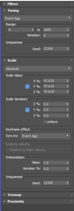

(08-05-2019, 08:52 AM)Borzacch Wrote:(08-04-2019, 04:36 AM)Jixal Wrote: Cool animation =). Hi there, could you please explain where you put the keyframes or how? I am trying to replicate the effect but cant seem to be able to "grow" the particles from scale 0 gradually to scale 100, my faces just jump from 0 straight to 100. I first set the faces scale to 0 then use a collision plane to send the 0 scaled particles to a new event where i set their scale to 100. thanks for the advice on this so far ![]() [EDIT] i just found out that i don't see the scale being animated only when i scrub the timeline in max... when i tried to grab a preview at 1/4 of timeline speed i see that the particles are actually scaled up but it happens so fast that its not noticeable at 1:1 speed. Is it possible to slow down this scale? I tried key frame offset but there is no change with whichever setting. Ill post a video in a while

(10-12-2019, 02:20 PM)jancijanci Wrote:(08-05-2019, 08:52 AM)Borzacch Wrote:(08-04-2019, 04:36 AM)Jixal Wrote: Cool animation =). First of you need to set timing to Event Age in scale operator. Second: set keyframes to scale from 0 to 100%. And dont forget about Sync option (Keyframe offset) - set it to Event Age. And thats all.
