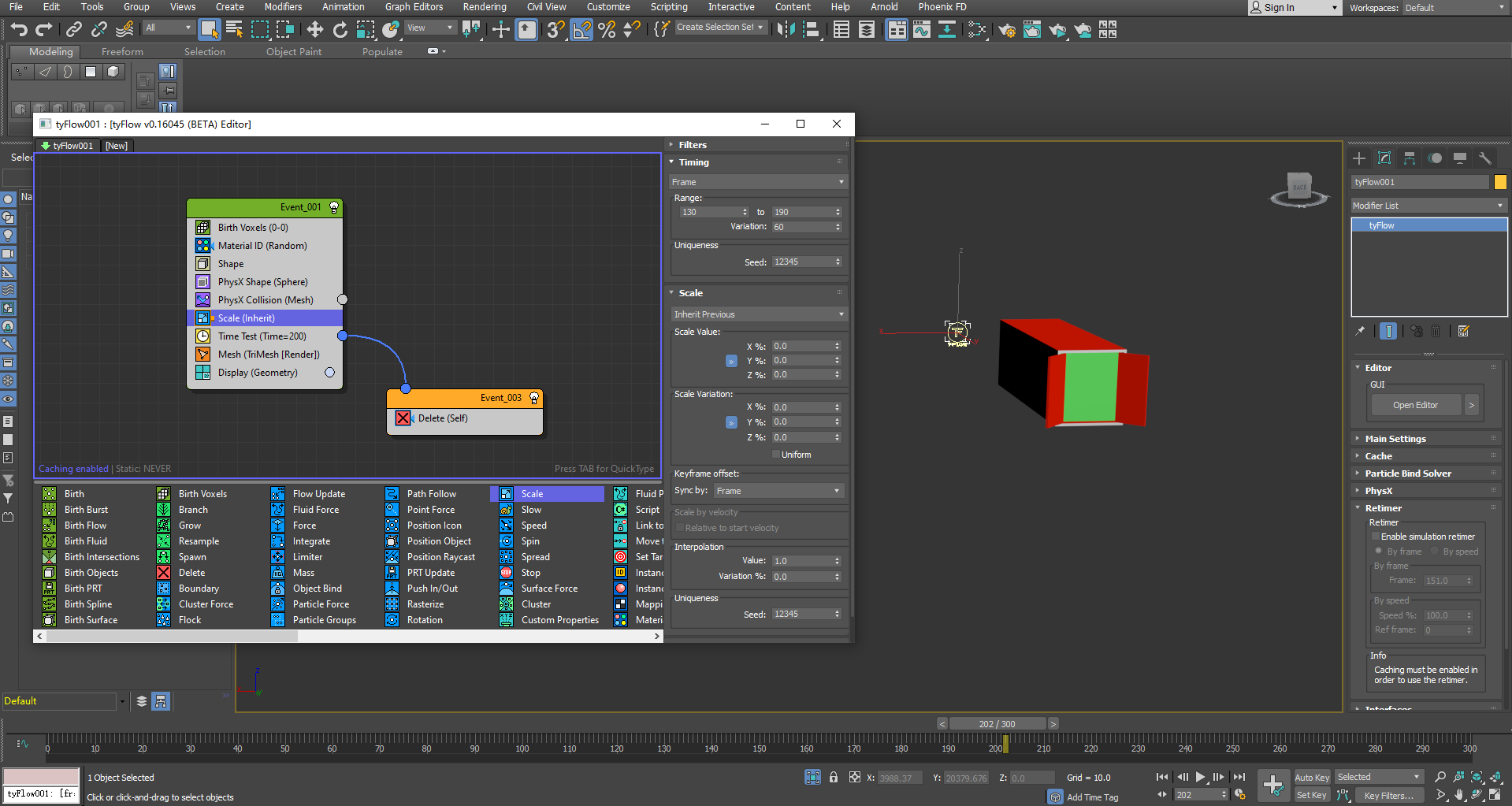

I want to let the particles be smaller and smaller and finally change to zero from 130 to 190 frame.
In "Scale" operator,  I set the "Timing->Range" ‘s value to "130 to 190", and set "Variation" 's value to "60", as follow:
But it is not the effect that I expect.  So how to achieve the desired effect?

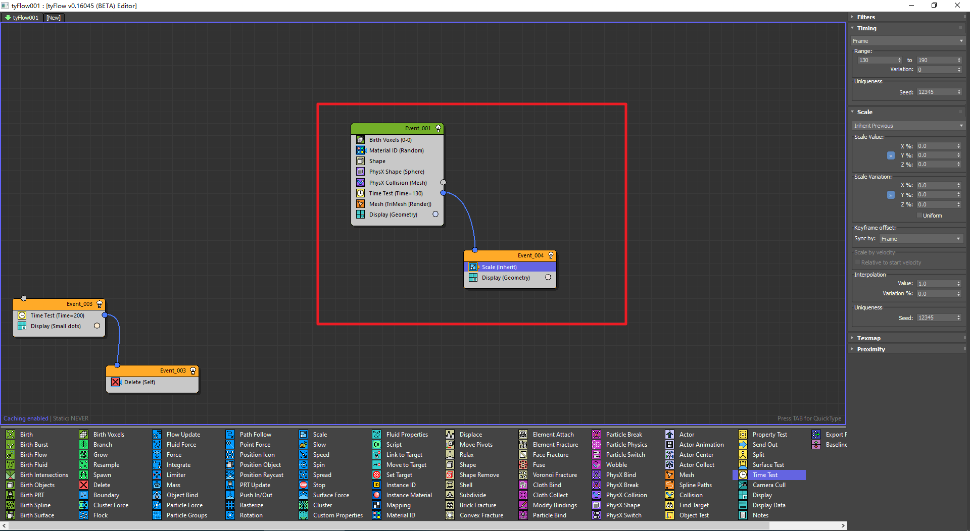

RE: How to control the speed of "Scale" change? - d4rk3lf - 08-31-2019
You need to change scale timing to continuous.
You don't need to make timing on the scale parameters, because after 130 frames, particles are already there.
Attaching you file.
You are doing pretty well, but you need to watch out and understand "timing" option in the scale, and other operators.
Well, it seems that balls completely disappear when scale is around 60-65%.
I am not sure why this is going on (maybe because of interpolation parameter)
So I animated to 60%, and extend scale animation to make it as close to 130-190.
You can tweak it further now, and get more precise... I just quickly did this.

ok , I get it. another guy said:
"Set scale to zero, set timing to continuous and then play with interpolation parameter (set it to lower value than the default 1) to control the speed of scaling."

RE: How to control the speed of "Scale" change? - tyFlow - 09-02-2019
Your Scale operator is set to "Continuous" and "Inherit" mode. This means each frame the previous scale is being inherited, and also shrunk by 60%. This will cause particles to scale to 0 over time.
