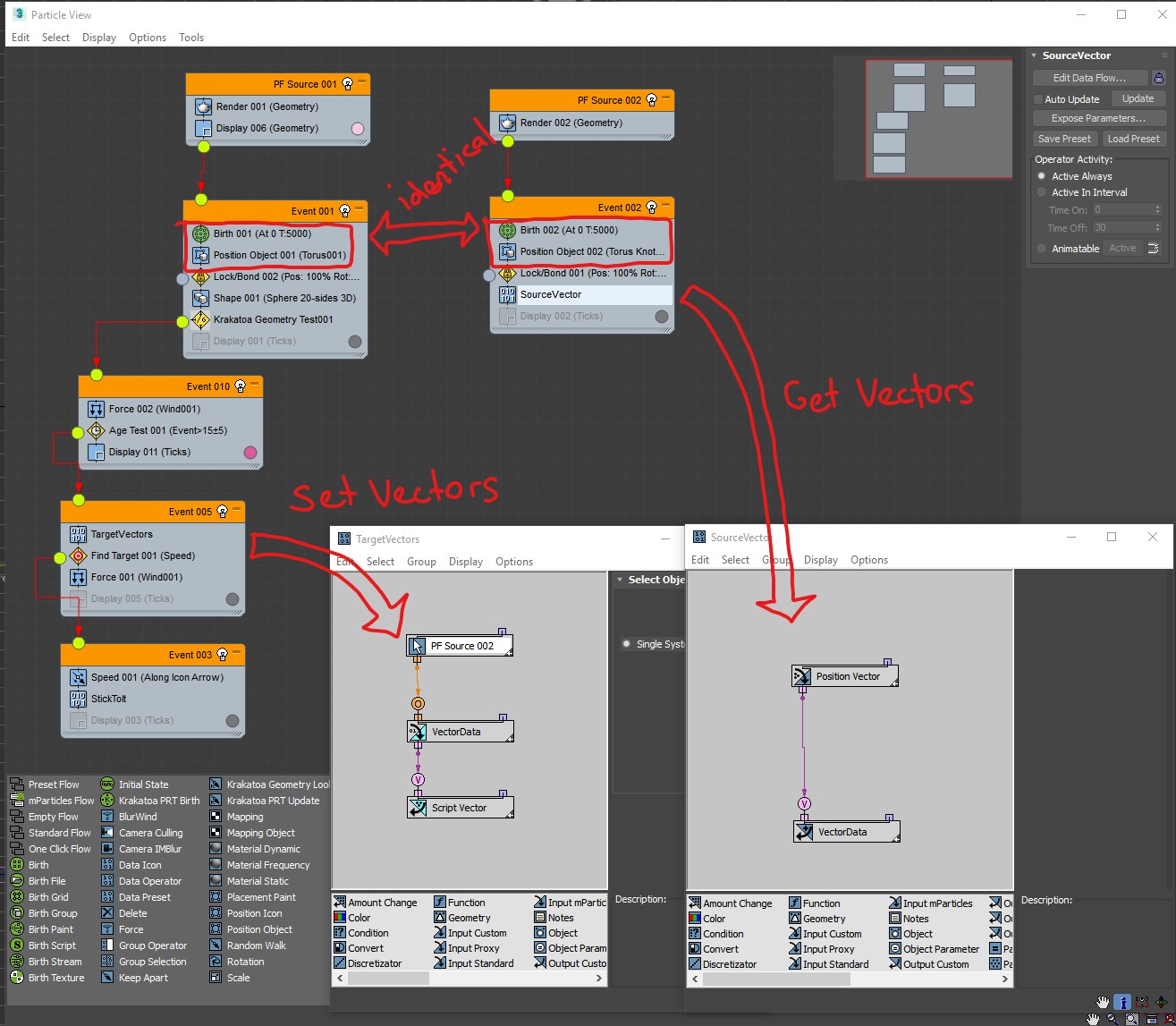

I used to use a simple trick with data operators to get/set data from different flows.
"Custom Properties" operator lets you do that in the same flow but not from other flows. Is there a way to achieve this in tyFlow?
I attached a simple snapshot to tell what I mean.
RE: Getting data from other events - tyFlow - 04-04-2019
Hmm, that's a tricky one...if your flows have exactly the same number of particles and you don't plan to delete any of them (so the offset between their indices will always stay the same), you could accomplish that pretty simply with a script operator.
Within the particle loop you'd just put this line:
Code:
int offset = 5000;
tf.SetCustomVector(sInx, "channelName", tf.GetCustomVector(sInx + offset, "channelName"));
RE: Getting data from other events - masqu3rad3 - 04-05-2019
Brilliant workaround. Never thought of that.
