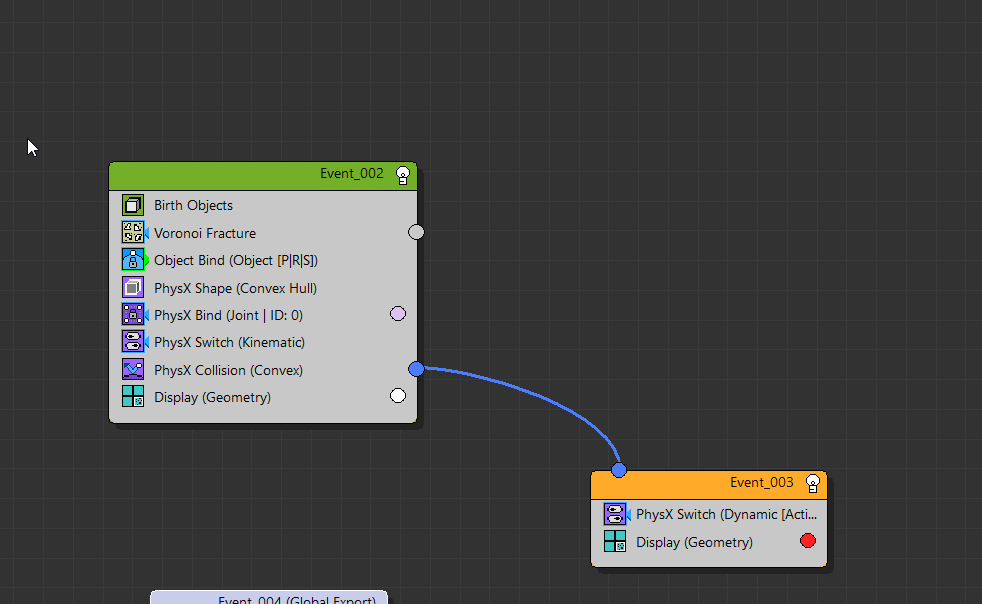

Tire deformation - dv2000 - 09-29-2019 Hi, What operators do i need so my car tires would deform against the surface like in this video https://youtu.be/C49md3uRw80 they wheel is linked to the car body. For some reason using birth shape with linked object makes this object disappear Thank you RE: Tire deformation - byvfx - 09-29-2019 (09-29-2019, 01:58 AM)dv2000 Wrote: Hi, i have attached a screenshot of a setup that will get you there, note in the physx collision if you source your ground as a particle you will need to turn on interparticle collisions. then just pop a tyParticleskin on your object referencing your flow RE: Tire deformation - dv2000 - 09-29-2019 (09-29-2019, 04:20 PM)byvfx Wrote:(09-29-2019, 01:58 AM)dv2000 Wrote: Hi, Thank you! |
