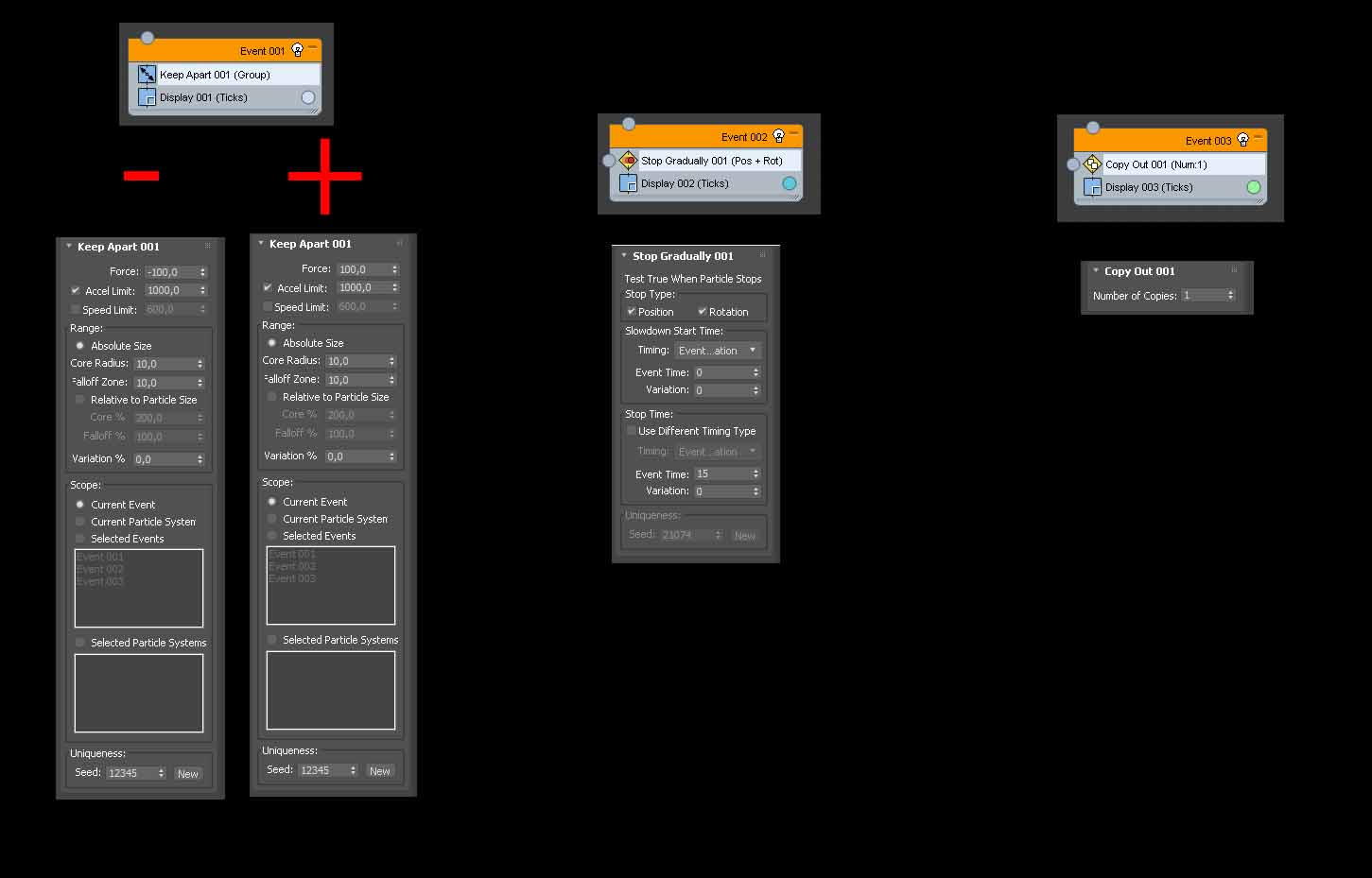

Love to See
Keep Apart Operator
And
Copy out Operator
Stop Gradually
Thank you.
RE: Copy out And Keap apart ,Stop Gradually - tyFlow - 04-04-2019
Keep Apart = Particle Physics operator in tyFlow.
I don't have a specific "Stop Gradually" operator, although you can try a "Slow" operator instead.
What does Copy Out do?
RE: Copy out And Keap apart ,Stop Gradually - Pflow - 04-04-2019
Keep Apart =  particle distance  of  +/-   radius.
Stop Gradually Is frame based. Slowdown by age.
Copy Out - Copys Out particle particles from event
See the Image
It is not the same.
The keep apart settings aren't identical of course, but Particle Physics can achieve the same result. That's why it was made.
You can combine a Slow operator with a Property Test (velocity) to send particles once they stop.
I'm still not quite sure what Copy Out does. Isn't that just like a Spawn operator?
RE: Copy out And Keap apart ,Stop Gradually - alexgiel - 04-23-2019
Copy out just copies the particles as they are (velocity vector, TM and spin) in a especific event, to another event. Not sending particles, but copies. The original ones stay in the previous event. Much like spawn, but I think more memory friendly.
