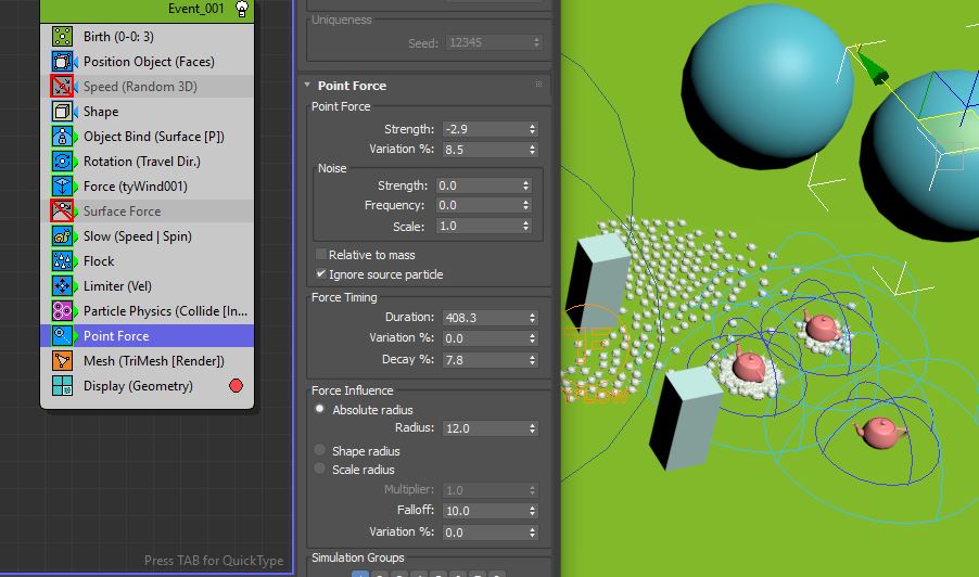

On point force if forces are less than zero, works as expected, image 1

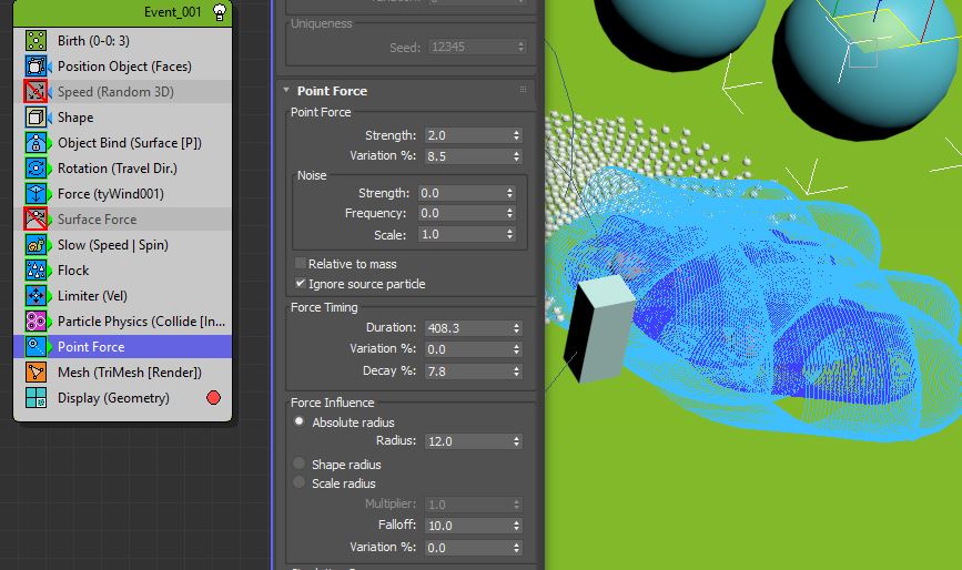

But if point force is bigger than zero, the show point forces, are redrawed each frame, (picture 2)
Oh now I see, it works together with the "Force timing", but not sure why its different when force is negative, maybe related with the decay?

Thanks Eloi, it was a bug related to Point Forces with a negative strength being removed too soon from the sim, even if their duration is set to be long.
Image #2 is actually correct...you have long durations on your Point Forces and your operator is set to continuous, so they're continually being generated.
