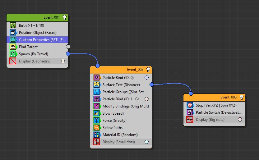

Question about one of the example files "tyFlow_freiOtto_001" - William - 11-18-2019 Hi, I have been experimenting with that specific file example, in it we get to see the particle binding/attraction happening creating a web like effect as soon as the particles or strings are generated. What I want to do is to tell the "Custom properties" node or operator responsible for the attraction to delay the attraction effect for X amount of frames, I would like the strings to settle first calmly for X amount of frames before the attraction effect kicks in. Unfortunately I found no way to do this yet, I tried animating the "Multiplier" parameter on the custom node but it doesn't seem to work while animated. Is there a way to do this? * Hate to add in a second quick question here, but any tips on how to apply multiple colors to the generated tyspline Tube meshes? *Edit:Managed to assign different mats by placing edit mesh modifier over Typline mesher and manually selecting elements assigning Id's + Materials to them, hope there is a more intuitive way to assign Mat Id's. Many thanks! RE: Question about one of the example files "tyFlow_freiOtto_001" - William - 11-20-2019 just want to bump this I'm still hoping someone has an answer or a hint on any of the points that could help, thank you in advance!
RE: Question about one of the example files "tyFlow_freiOtto_001" - tyFlow - 11-21-2019 Why not set the timing properties on the Bind operator to wait until the frame you want? RE: Question about one of the example files "tyFlow_freiOtto_001" - William - 11-21-2019 (11-21-2019, 03:47 AM)tyFlow Wrote: Why not set the timing properties on the Bind operator to wait until the frame you want? First, thank you again for your reply! If I understand you correctly, you would like me to set timing properties on the "Custom properties" node (attachment below). I tried that unfortunately has no affect. I tried different things such as age and frame. Perhaps I am missing something or approaching it in a wrong way. Also I can't wait until the frame I want because the frame I want does not have the time to exist, The particles shoot out as strings and immediately web together no time is given for them to settle first. RE: Question about one of the example files "tyFlow_freiOtto_001" - tyFlow - 11-21-2019 Nope not Custom Properties...the Bind operator as mentioned above (in particular, the second Bind operator creating bindings with ID=1). It's what creates the attraction, so it's what you want to delay. So, for example, set it's timing to "frame 50-125" and it'll only create attraction between those frames. You can enable its "show bindings" option to see exactly what it's doing. RE: Question about one of the example files "tyFlow_freiOtto_001" - William - 11-22-2019 (11-21-2019, 11:51 PM)tyFlow Wrote: Nope not Custom Properties...the Bind operator as mentioned above (in particular, the second Bind operator creating bindings with ID=1). Oh I get you that works! All this time I thought it was the custom operator working the attraction and particle binding was exclusively for the string creation. Thank you for your time. |
