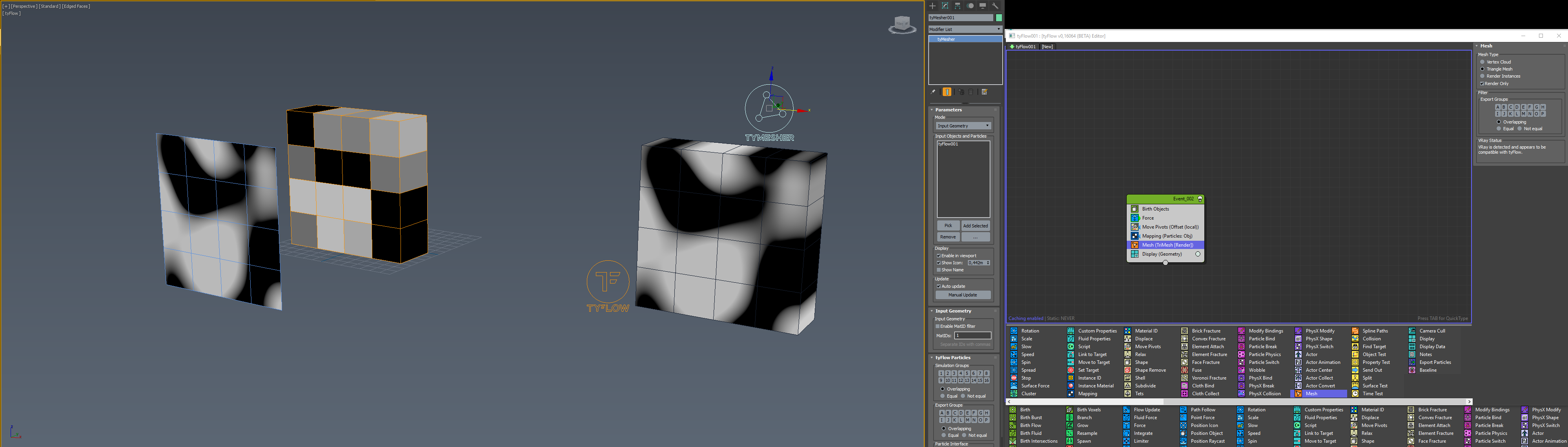

Hey Tyson,
tyMesher does not keep UV values applied in the mapping Operator.
You can see in the screenshot im sampling the noise map with mapping Operator.
When i mesh the Flow, using tymesh "input geometry" mode, its losing the mapping.
Do i need to bake the UVs with some other Operator?
Thanks in advance any help appreciated))
RE: tyMesher and Mapping - tyFlow - 02-29-2020
Did you enable the "inherit UVWs" option in the tyMesher? It's off by default.
RE: tyMesher and Mapping - usc001 - 05-11-2020
my late reply)
the version i had installed didnt have that option.
But i found it after i updated thanks!
