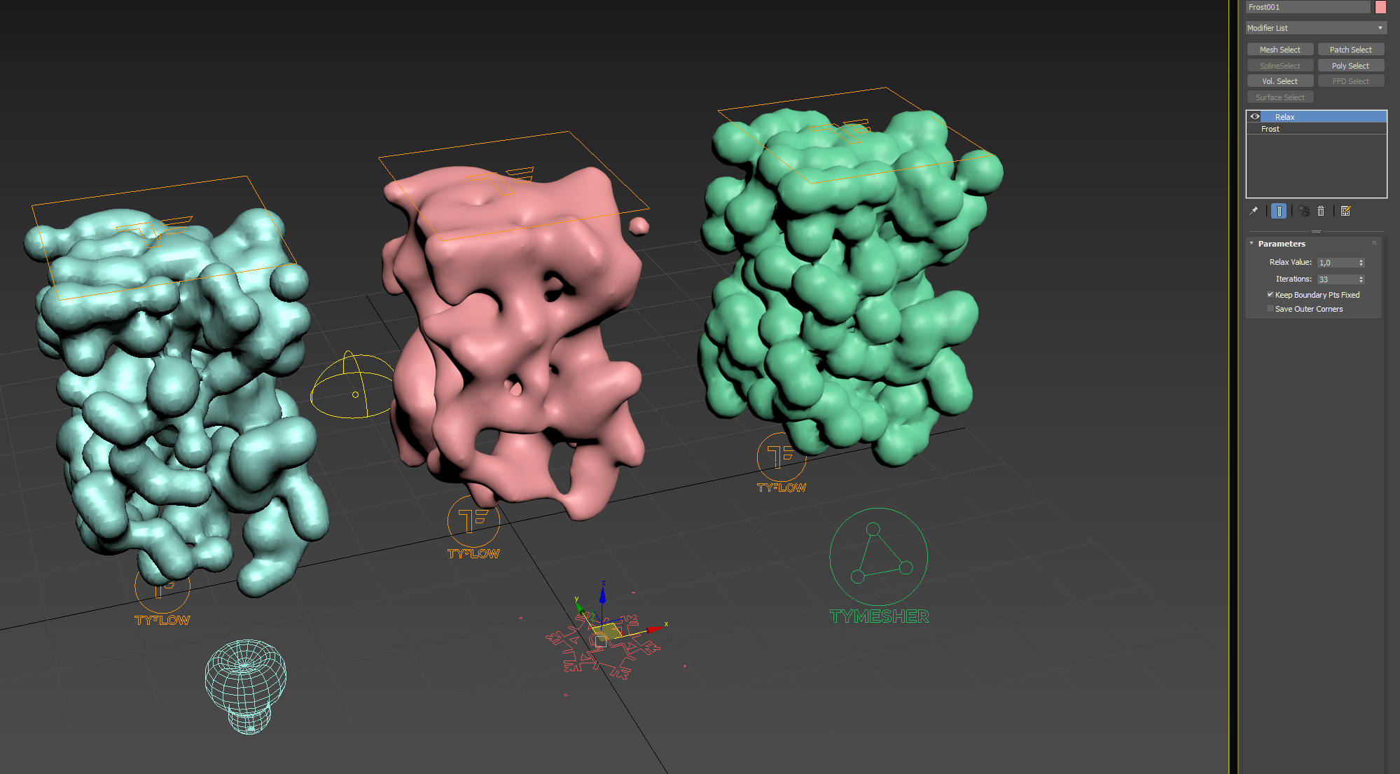

RE: Motion Blur for TyMesher? - Tomb - 08-20-2021 Can this same solution be used with VDB's as well? Or does it only work with tymesher? RE: Motion Blur for TyMesher? - lemo - 01-07-2022 Hello, I tried to apply the method but it didn't work for me. I probably did something wrong but I won't have motion blur on my tyCache mesh even if my particles do have velocity informations. I'm using 3dsmax 2020 and vrayNext Here is how my scene looks ![]() ![]() render of the tyCache mesh : ![]() render of the particles only : ![]() If any one has a solution for this, that would help me so much! |
