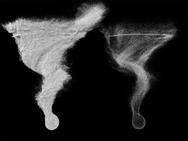

Partitions - pati - 08-26-2020 Hello. When export particles, I want to not use the partitions. Is it can? Now, Tyflow exporting Write 100 times at once.it is very very slow for to use krakatoa. So I reduced paritions and exported. but the particle amout will also decrease... RE: Partitions - tyFlow - 09-02-2020 I don't really understand what the problem is....if you export 100 partitions, then yes it will take 100 times longer. Partitions give you a rendering advantage (allowing you to render insanely huge numbers of particles), they don't give a speed advantage within tyFlow itself. Usually the best way to export partitions is to have a renderfarm which is managed by Thinkbox's Deadline and then use the export with Deadline option in tyFlow. That way, for example, if you have 100 machines on your farm, you can export 100 partitions at the same time. |
