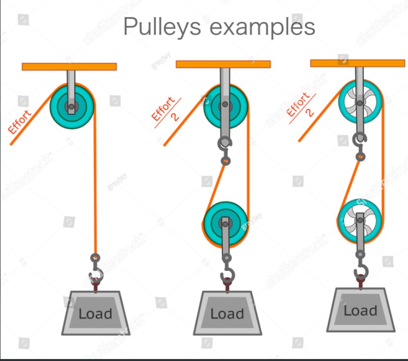

I am making a course for 3ds max and I have my final test. If have to task to make chain reactions with 3ds max.
So I have looked everywhere for a tutorial.... splines binding... but nothing helps me or give the help I need.
I want to make a pulley with rope animation as per the picture attachment.
Is there anybody who could help me how to do that ? Is ist possible to make this with tyflow.

Many thks, Yes I have seen this scen... and checked.  The problem is with pulley I have to forces which are addicted to each other and further the rope should rotate around the pulley.

If you construct pulley with several convex objects (same as chain in chain sample), it should work.
But in order to make it really precise, you'll need to make series of tests of trials and errors...

Well, from the chain sample scene you can learn that you can create proper concave 3D models that works with PhysX if you brake them apart to small pieces.
In your case, that would be the pulley.
For the rope, you can simply scatter small boxes on the spline (with same distance), and use these boxes to drive the rope animation with PhysX and PhysX bind.
Then you can add a spline paths (by PhysX Binds) operator, so it creates spline, that you can render as a rope.
Hope this helps.
