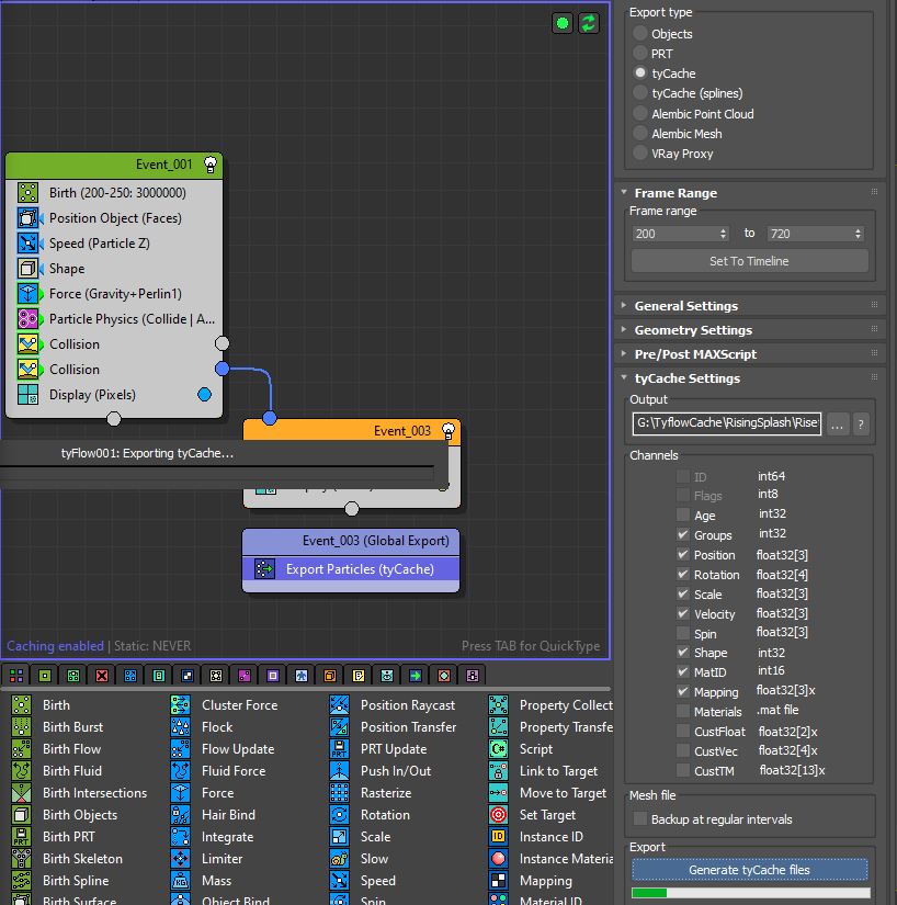

Tyflow Crash when Exporting Particles - GALACTUS - 08-10-2021 Hi All I have a persistent crash in Tyflow when exporting particles. I have exported the very same flow unaltered twice before, but now it crashes constantly just about 70% through. I have done the following but with negative results. 1: Restart max 2: Changed the Step from 1/8 to 1/6 3: Lower total particles from 4m to 3m 4: Restarted the system 5: Updated Tyflow to the latest build when the crashes started VER-0.016126 I have also attached an image of the flow. The system has 64GB of memory and stores the cached data on a dedicated SSD. Any assistance would be welcomed. Thanks RE: Tyflow Crash when Exporting Particles - tyFlow - 08-10-2021 I'd need to see a minidump for this. Please see this post: https://forum.tyflow.com/thread-717.html RE: Tyflow Crash when Exporting Particles - GALACTUS - 08-12-2021 (08-10-2021, 10:31 PM)tyFlow Wrote: I'd need to see a minidump for this. Please see this post: Thanks, sent the Tyflow.log file and will send through the Minidump file. |
