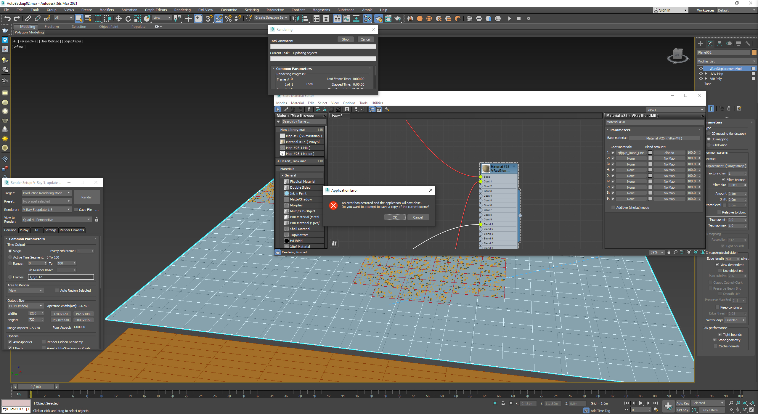

Scene crashing often with simple flow - Viacheslav - 09-26-2021 Hi, I'm testing tyflow particles on the isolated and simple scene, before recreating the effect on the main scene which is memory intense. Crashes are quite frequent and it seem to happen with faces being selected(position object mesh). The flow is quite basic, before the crash it says Tyflow collecting Tm. Am I doing something wrong or its unstable? If so, how I suppose to approach a much harder scene? Edit, doing further tests and it seems that Crash happens when I press Render while selecting Editable poly ---->Polygon selection. RE: Scene crashing often with simple flow - tyFlow - 09-26-2021 Please see: https://forum.tyflow.com/thread-717.html |
