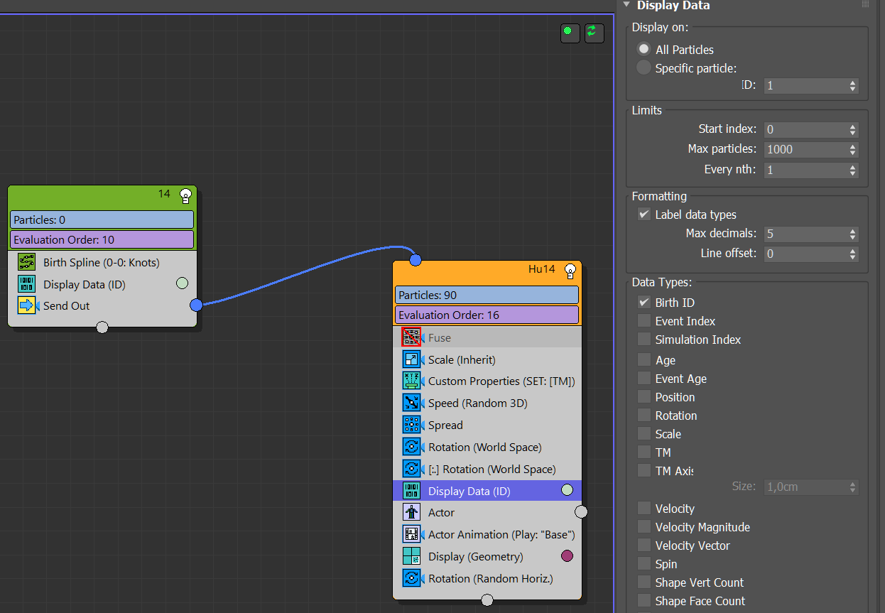

How to display Birth ID with Display Data? - Alexx31 - 12-03-2021 Hello, I have 5 Actors in a scene and I want to rotate only one of them. So I'm using a filter by Birth ID. To get the Birth ID I tryid Display Data, but it does not show any information at all in the Viewport. Is there anything else to do, in order to get the IDs visible? A special VP view mode or a Display operator? Thanks RE: How to display Birth ID with Display Data? - tyFlow - 12-03-2021 That should be all you need. Are you using the latest build of tyFlow? RE: How to display Birth ID with Display Data? - Alexx31 - 12-03-2021 I think it was 16131, I will check it with 16132 and give feedback. (max2022) Thanks RE: How to display Birth ID with Display Data? - tyFlow - 12-04-2021 Make sure you don't have any active modifiers on your flow object. Any active modifiers on a flow object will disable the base object drawing methods. You'll see meshes and stuff, but not the text display types shown by the Display Data operator. If you do have modifiers, you don't have to remove them for Display Data view...just disable in the view. RE: How to display Birth ID with Display Data? - Alexx31 - 12-07-2021 Great! that was the reason, thanks It only doesn't help to see the root particle ID, which I need to get to rotate the actor. Each actor consists of many particles. Is there a way only to display the root particle? Thanks (12-04-2021, 01:46 AM)tyFlow Wrote: Make sure you don't have any active modifiers on your flow object. Any active modifiers on a flow object will disable the base object drawing methods. You'll see meshes and stuff, but not the text display types shown by the Display Data operator. If you do have modifiers, you don't have to remove them for Display Data view...just disable in the view. RE: How to display Birth ID with Display Data? - tyFlow - 12-07-2021 You can send just the root particles (or just the rig particles) to another event using the output node of the Actor operator. Then just put the Display Data in there. RE: How to display Birth ID with Display Data? - fyfx - 12-08-2021 (12-07-2021, 10:11 PM)tyFlow Wrote: You can send just the root particles (or just the rig particles) to another event using the output node of the Actor operator. Then just put the Display Data in there. How to render these ID numbers? Particle shape has no Numbers and letters option. |
