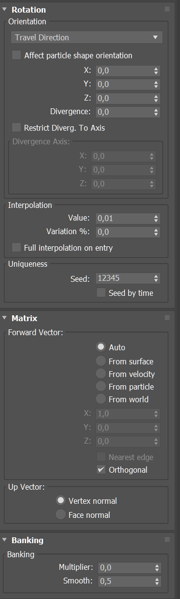

Hello,
I am trying to get a natural orientation for actors.
With "travel direction" I get a good starting base, but I would need it only with a smaller influence, otherwise, it looks in this case too artificial.
Is there a way to reduce the influence?

I'm not sure what you mean by influence. Typically to smooth things out you'd decrease the interpolation, but I can see you've already set that really low...so I'm not sure what else you're after.

Thanks, this is known from forces (or constraints in Maya Wink
You can weigh how much influence a force has.
For example, PathFollow has an influence as far as I remember.
If the actor should not look robotic in the direction, especially a bird on its way, instead just look generally in that direction but still react to other forces, too, then an "influence slider" would be helpful.
