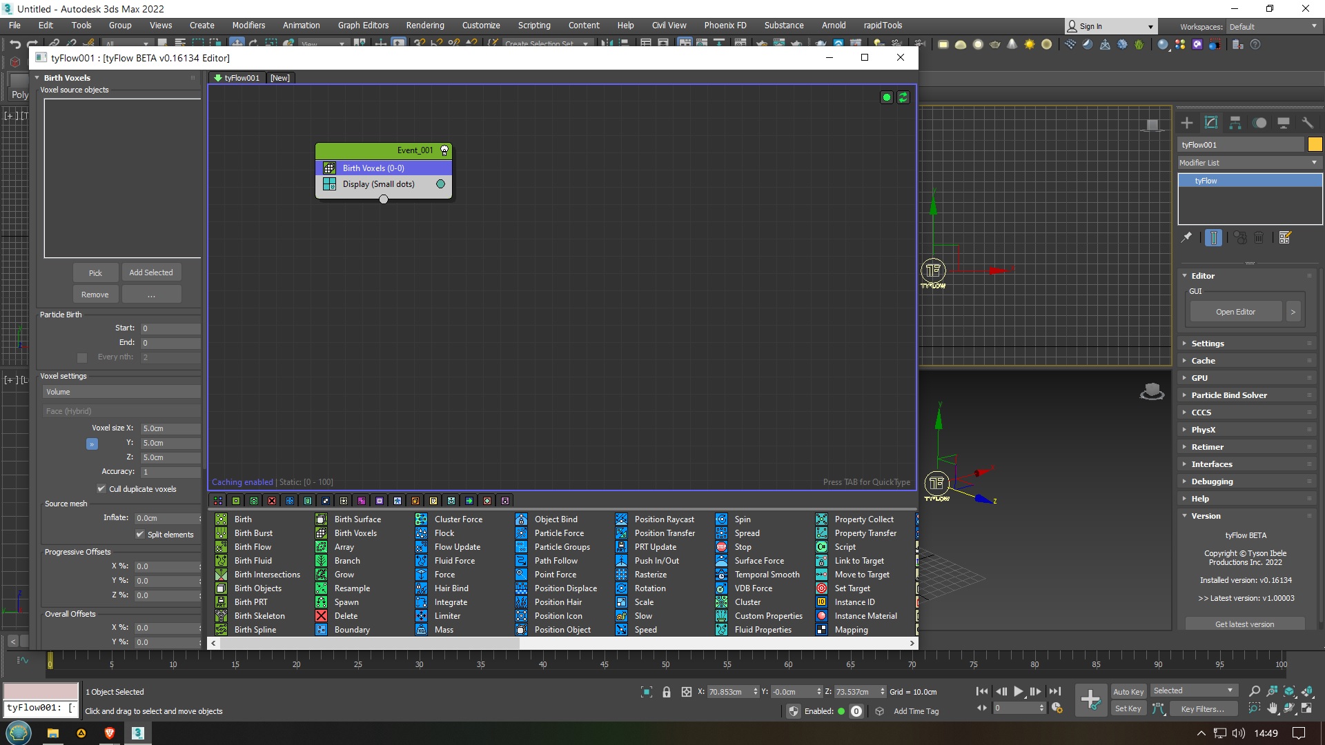

Interface being cut off. - MartG - 03-05-2022 Hi I,m new to this forum. ![]() I just wanted to ask about a minor issue I'm having with part of the TyFlow interface being cut off As you can see I can't access the spinners, it's same in windowed or full screen and rollups docked on the left or right. it's not really a big deal as I can still input the numbers but I was wondering if there's a simple fix. RE: Interface being cut off. - tyFlow - 03-06-2022 That's actually a very, very old issue and it has to do with certain windows scaling configurations. There's a setting in the tyFlow Debugging rollout to manually expand the width of the rollouts, as a workaround. Just increase the value in there a bit until you can see the spinners. I believe the setting is sticky so it should load between Max sessions. RE: Interface being cut off. - MartG - 03-06-2022 (03-06-2022, 08:02 AM)tyFlow Wrote: That's actually a very, very old issue and it has to do with certain windows scaling configurations. Thanks very much! |
