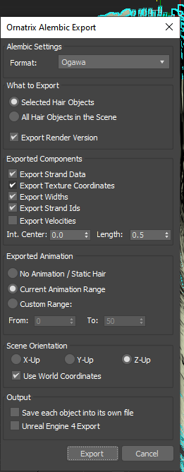

ornatrix alembic & Position Hair - ldotchopz - 05-22-2022 The Position Hair works great on the ornatrix hair, but when I need to cache everything out as Ox alembic, the Position Hair doesn't let you select the ox alembic. is there a work around for this? RE: ornatrix alembic & Position Hair - tyFlow - 05-22-2022 You will have to cache them separately. RE: ornatrix alembic & Position Hair - ldotchopz - 05-22-2022 (05-22-2022, 05:34 PM)tyFlow Wrote: You will have to cache them separately. I am caching them seperately, tyflow just doesn't let me select the imported ox alembic. So you're saying Position Hair should be able to select the ox alembic? Cheers! RE: ornatrix alembic & Position Hair - tyFlow - 05-22-2022 Oh sorry, I misunderstood the question. Position Hair needs to select the uncached hair object to read the necessary internal hair data. RE: ornatrix alembic & Position Hair - ldotchopz - 05-22-2022 (05-22-2022, 07:44 PM)tyFlow Wrote: Oh sorry, I misunderstood the question. ah okay, good to know i think i know a workaround to get it work in sync with the alembic. that said it would be great if tyflow could see ox alembic. i believe it when you export ox alembic it stores most of the data. could it be intergrated do you think? Cheers! RE: ornatrix alembic & Position Hair - tyFlow - 05-25-2022 Ox alembic doesn't expose the necessary interface that tyFlow needs to read, so I don't think it will be possible, no. |
