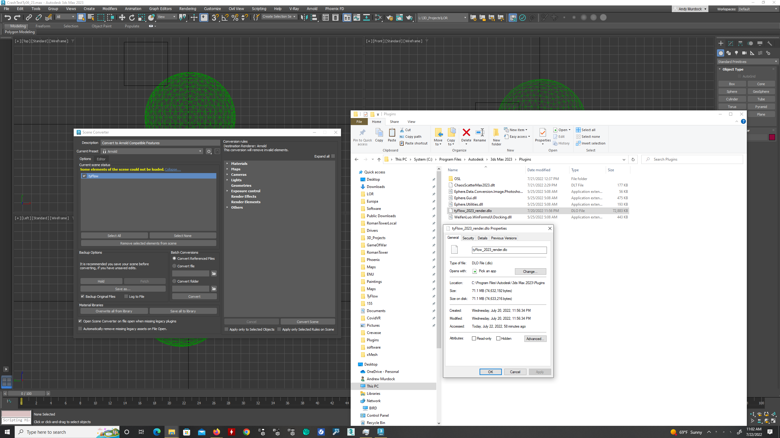

I put TyFlow_2023_render.dlo  1.006  in 3dsmax 2023 and renders would crash.
So I opened the scene on that render machine got the attached dialogue.
If I delete TyFlow objects from the scene it will render.
Andy
RE: TyFlow_2023_render.dlo 1.006 won't load - tyFlow - 07-22-2022
Hey Andy,
tyFlow_RENDER won't load at all in UI mode, so that's why it says it's missing.
As for the crash, is a minidump generated? If so, please send.
Finally, is this happening on a machine with a valid tyFlow license activated? In other words, have you activated your license on this machine and are now trying to use tyFlow_RENDER on it? Or is this a machine that is completely deactivated (no node-locked or floating license configuration on it). I recently fixed a bug related to the former scenario (a valid license exists on the machine but tyFlow_RENDER is being used)....it was snuck into v1.006 a couple days after I originally posted v1.006....you could try to re-download tyFlow_RENDER and try again to see if the fix applies to your situation...
