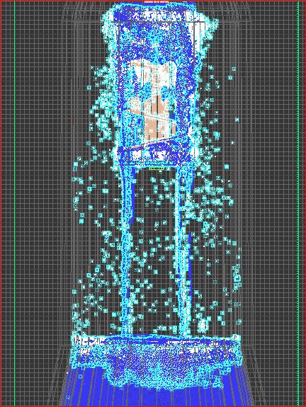

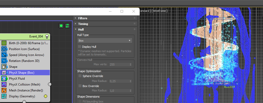

PhysX issue - JuhaHo - 07-30-2022 I wonder what I'm doing wrong, but PhysX collision nor PhysX fluids do not have any visible effect in my system. This very same setup is working fine on other scenes I've tested it, but not in my production scene. Any ideas where to start digging into this? RE: PhysX issue - tyFlow - 07-30-2022 PhysX Shape "mesh" type is not supported by dynamic particles, as stated in the rollout in your screenshot. If you want particles to be affected by PhysX forces, you need to use some other shape type ("mesh" is only supported for kinematic PhysX particles). RE: PhysX issue - JuhaHo - 07-31-2022 Thanks, it helped. I see now some interaction with particles and geometry. Now I need to find a way for keeping the particles inside the liquid. The liquid is there for moving particles through ducting. RE: PhysX issue - JuhaHo - 08-01-2022 Here's the last night results. At the moment, the biggest issue is loose particles outside of the liquid. I wonder what parameter is affecting those. RE: PhysX issue - JuhaHo - 08-03-2022 So what operators I should look into, if I want to keep the particles inside the fluid? Edit: Additional screenshot of the issue. RE: PhysX issue - tyFlow - 08-03-2022 Your screenshots aren't really doing anything to make the issue clear. Maybe a video preview would be better. RE: PhysX issue - JuhaHo - 08-03-2022 I hope this is better. All the particles should be inside the liquid. |
