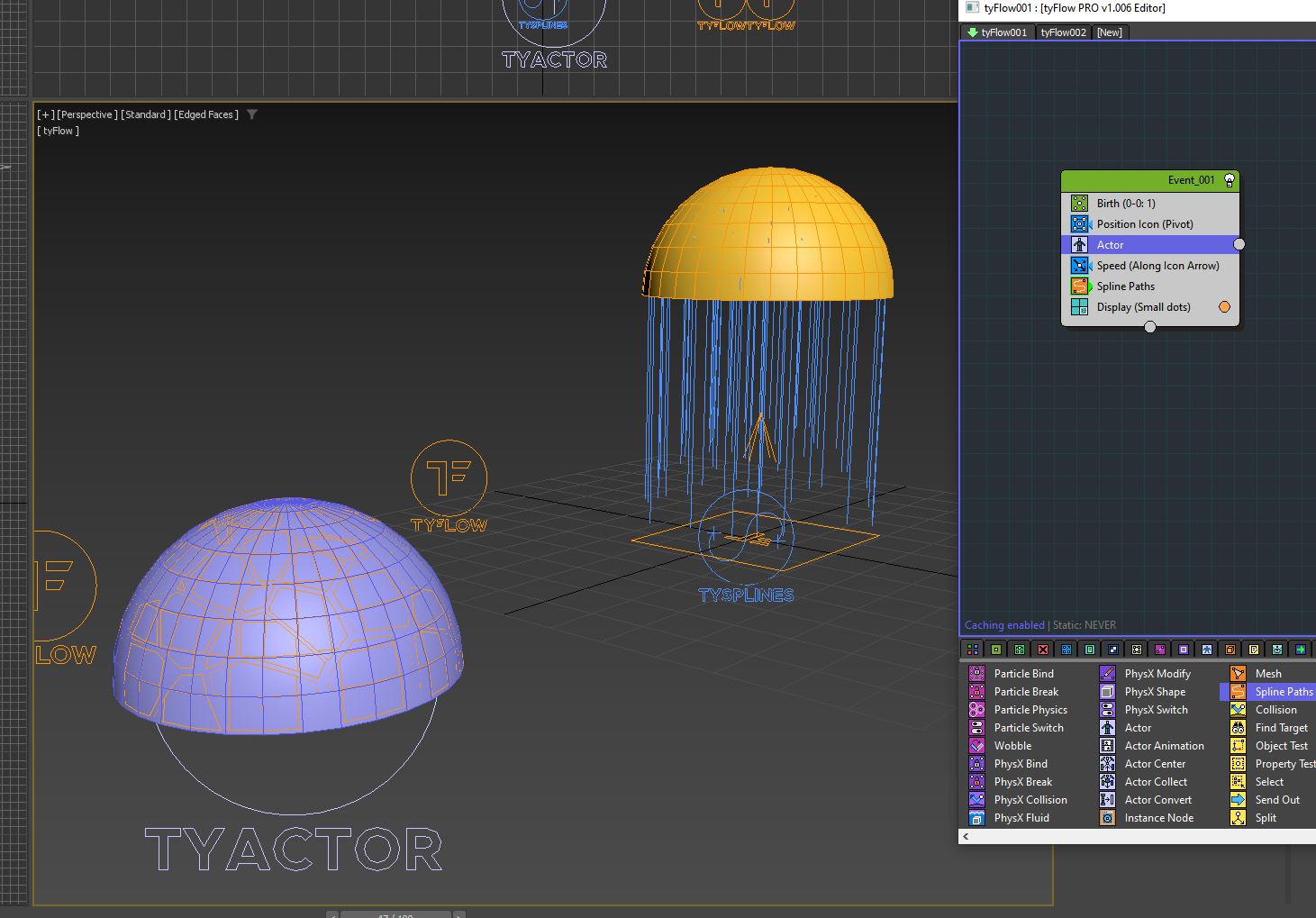

tysplines for every actor particle - ldotchopz - 08-09-2022 I have a particle moving upwards with tyspline trajectory being drawn as it moves up. I wanted to place an actor where the particle is. but when i do, it uses all the actor particles to draw the spline trajectory. Is there a way of ignoring this as seeing it as a single particle? similar to if you added a shape, no more splines would be drawn. Thanks! RE: tysplines for every actor particle - tyFlow - 08-09-2022 Use the output node on the Actor operator to send the rig particles to another event. RE: tysplines for every actor particle - ldotchopz - 08-11-2022 (08-09-2022, 10:29 PM)tyFlow Wrote: Use the output node on the Actor operator to send the rig particles to another event. Thanks a lot! |
