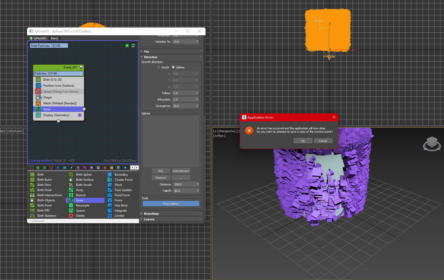

3dsmax crashes when the grow operator draws splines. - cgdvs - 09-03-2022 HI,Tyson! 3dsmax crashes when the grow operator draws splines. You take a vacation first, I'll put it here, and you can watch it later. RE: 3dsmax crashes when the grow operator draws splines. - cgdvs - 09-03-2022 Well, I finally tested the cause of the crash. When I drew for the first time, I selected the "tyicon001" object, and the system will crash immediately when I click it. At this time, cancel the drawing, do not select anything, and click to draw the line again, and then there is no problem. Strictly speaking, this is not a "bug", but it does cause Max to crash. By the way, when there are no objects in the scene, drawing curves will also crash RE: 3dsmax crashes when the grow operator draws splines. - tyFlow - 09-04-2022 Thank you, I will work on getting this fixed. |
