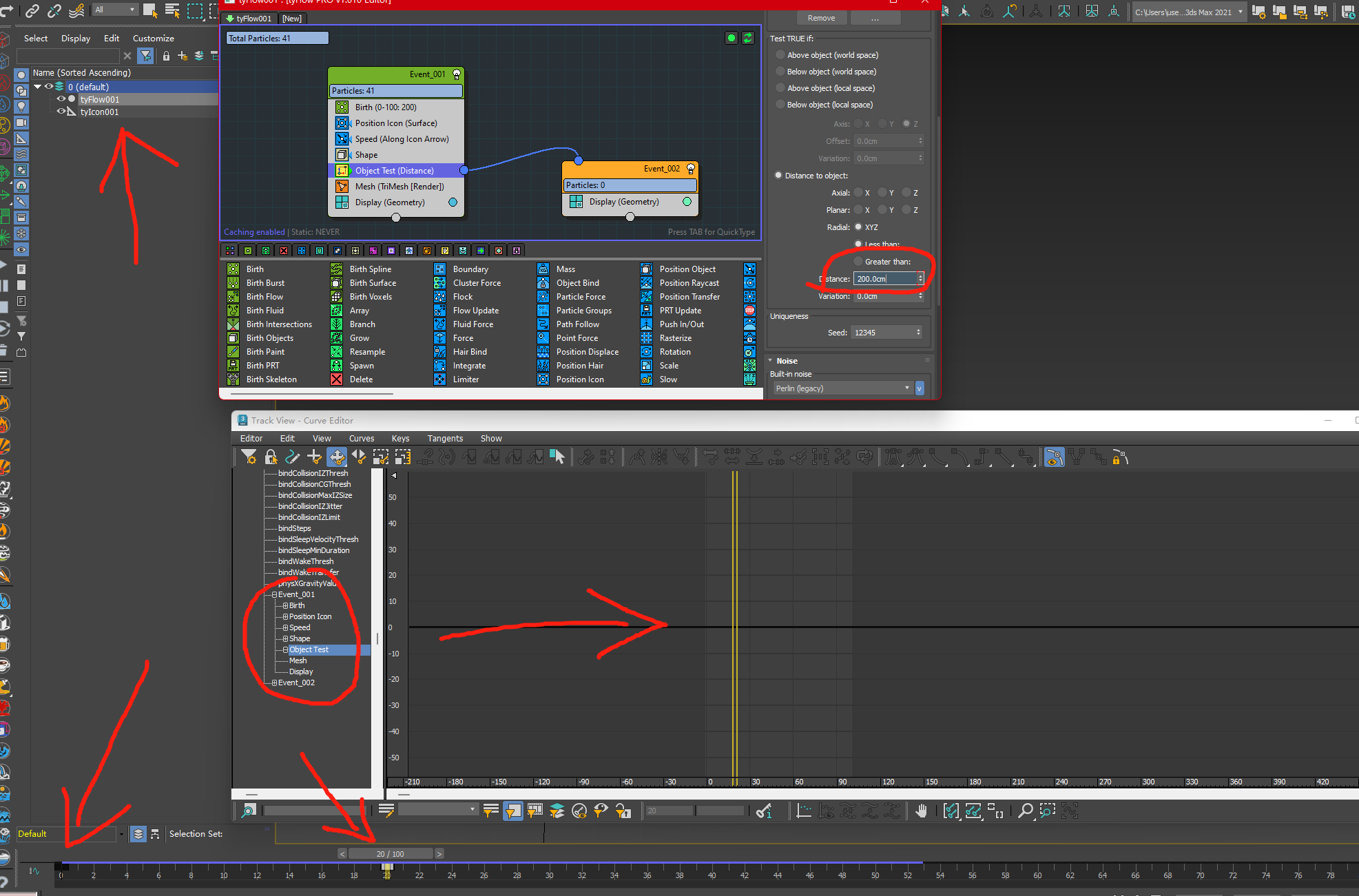

The key frame in tyflow1.010 cannot be found in the curve editor. Please check. - cgdvs - 09-03-2022 HI,Tyson! The key frame in tyflow1.010 cannot be found in the curve editor. Please check. RE: The key frame in tyflow1.010 cannot be found in the curve editor. Please check. - tyFlow - 09-04-2022 You need to either select the tyFlow object, or enable global tracks display in the curve editor. RE: The key frame in tyflow1.010 cannot be found in the curve editor. Please check. - cgdvs - 09-04-2022 (09-04-2022, 05:12 PM)tyFlow Wrote: You need to either select the tyFlow object, or enable global tracks display in the curve editor. What I said is that with the tyflow object selected, open the curve editor and expand the relevant attributes without any key frames. RE: The key frame in tyflow1.010 cannot be found in the curve editor. Please check. - tyFlow - 09-05-2022 Yes, as I mentioned you need to enable global tracks. Click 'filters' in the Curve Editor and enable global tracks on the bottom left. RE: The key frame in tyflow1.010 cannot be found in the curve editor. Please check. - cgdvs - 09-05-2022 (09-05-2022, 12:59 AM)tyFlow Wrote: Yes, as I mentioned you need to enable global tracks. ok, thank you! I seem to remember that I didn't need to do this before. Maybe I remember it wrong. |
