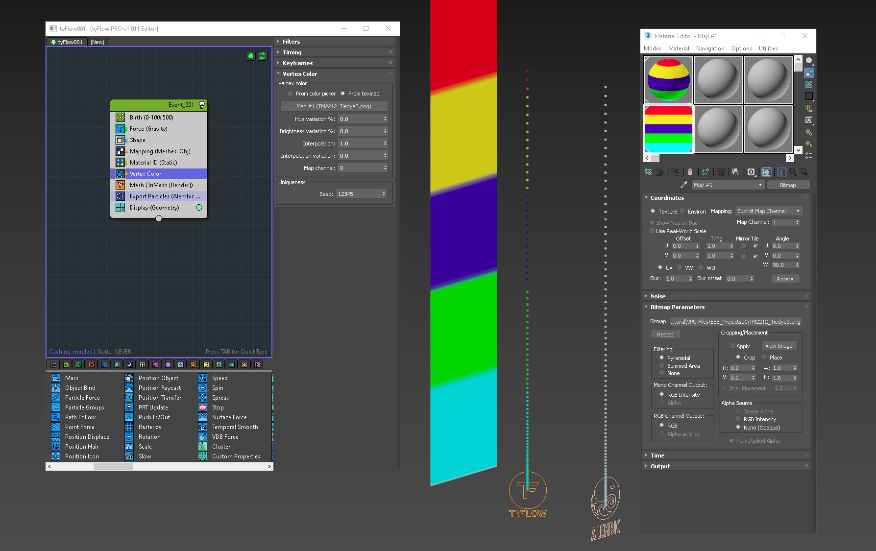

Trying to figure out how to add the color when exporting to Alembic.   I thought maybe Vertex color operator would do the trick but doesn't seem to work.
Created a simple test file.   but can't seem to get this to work.
Any advise is appreciated.

If anyone else runs in to this issue,  what I had to change to get this to work.
*  Make sure the map channel for both the Vertex and Export operators is set to 1.
* Mapping mode in the Mapping particles operator needs to be set to "Affect particle mapping overrides"
Note:  We only turn the Vertex color operator on when exporting,  We leave it off while working so as to be able to see color properly in the viewport.
