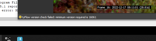

tyflow version check failed - Redshift & backburner - ldotchopz - 12-17-2022 I am testing tyFlow Render using backburner and Redshift. This error appears while rendering in redshift. My backburner node renders 1 frame and then fails. I don't actually know if these 2 things are related, but this message does appear in the rendshift frame buffer and I would like to address it just in case. Do you know why this would be showing? Both tyflow on my main machine and the render nose are the latest versions with the latest CUDA DLLs Thanks RE: tyflow version check failed - Redshift & backburner - tyFlow - 12-17-2022 Are you running tyFlow_render on the node? If so, this is a known issue that will be fixed in the next build. Workaround is to remove tyFlow_render and replace with regular tyFlow for now. It’ll run single-threaded, but shouldn’t error out. RE: tyflow version check failed - Redshift & backburner - ldotchopz - 12-18-2022 (12-17-2022, 05:36 PM)tyFlow Wrote: Are you running tyFlow_render on the node? If so, this is a known issue that will be fixed in the next build. Fantastic thanks! |
