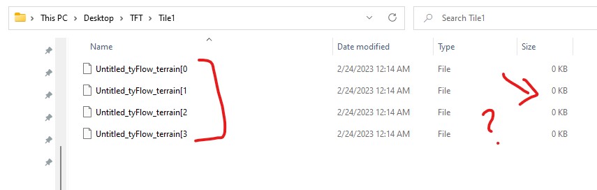

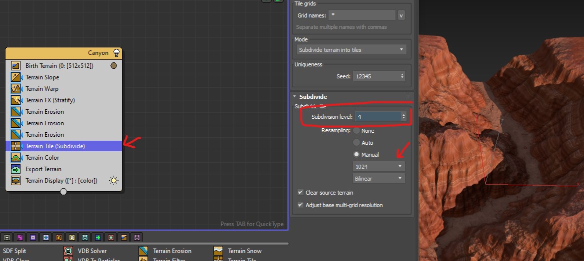

I used tile when I do export the maps, just exporting 4 files without any extension or data.
IDK if is it a bug or if it is my wrong workflow, I attached images step by step.

It seems on new version solved the tile export, also I get the answer for the land expansion solution you already answered in 1.014 version.
