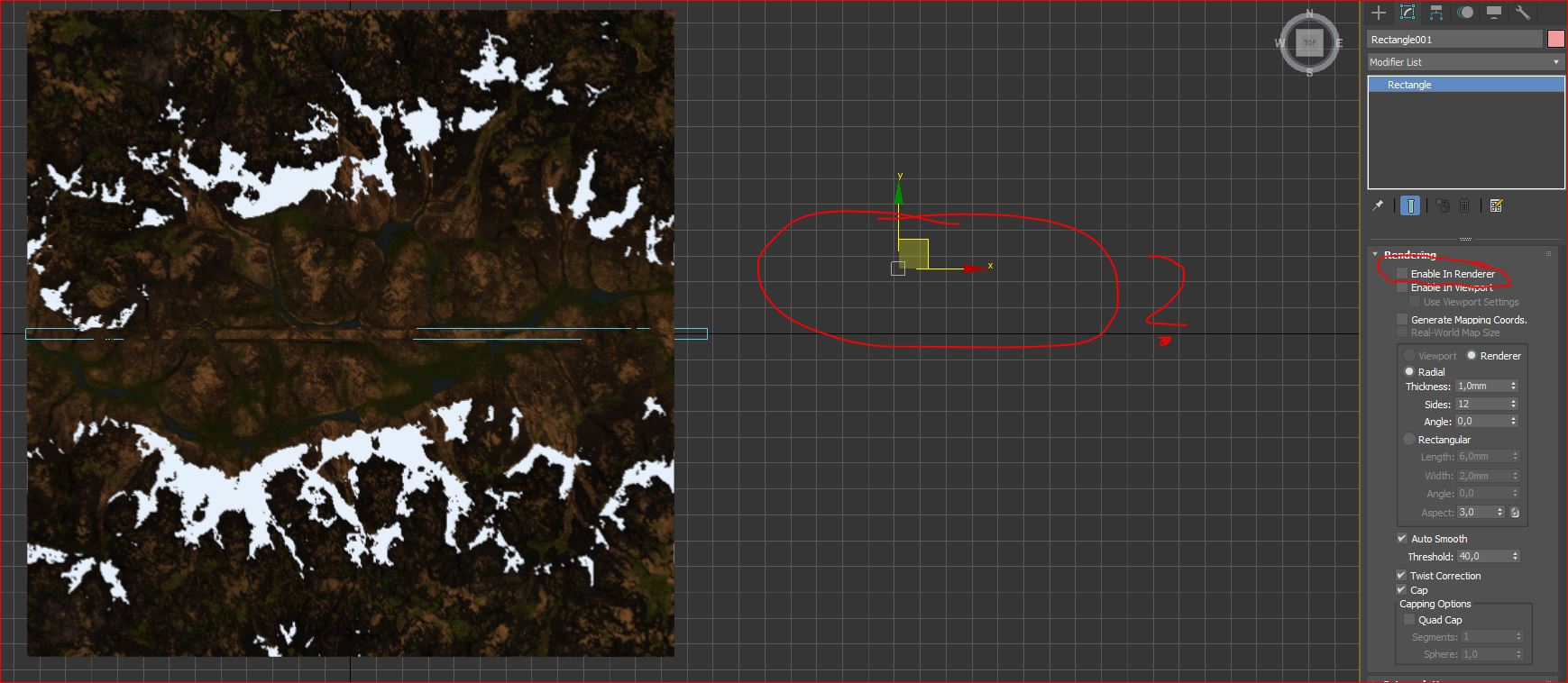

I found also other interesting thing. When tyFlow is used splines are not visible. They will become visible when enable in renderer is activated.
RE: Terrain workflow - tyFlow - 04-14-2023
Units are completely arbitrary and are dependent on your scene unit setup.
Not sure what's going on with that spline...

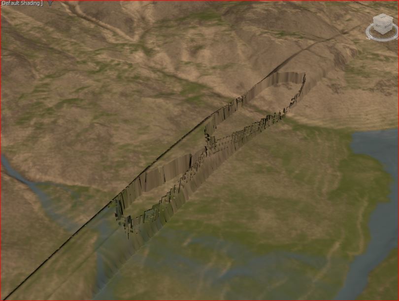

I have some problems understanding the Object to terrain operator. I wonder why there's a hole on my road. Then I wonder if it's possible to define the road color. Now it uses the shape geometry (that requires some fine tuning).
That's a pretty odd artifact...if you send me the file I can take a look at what's going on. Going to be hard to distill the cause from a screenshot alone.
You can define road color, yes. In the Object to Terrain operator you can export the influence of the object as mask, then use that mask in the Terrain Color operator to isolate the road areas and define their color.
