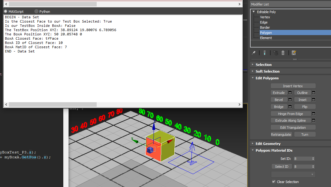

Possible Bug - Script Op MatID value - rjanders0003 - 06-15-2023 G'Day Mate It seems the matID returns a value 1 less than actual - ie: Max Mat ID is 8, it returns 7. Max Mat ID is 1, it returns 0. Is this the proper behavior or should it match Max ID value? Image Attached. Rob RE: Possible Bug - Script Op MatID value - tyFlow - 06-15-2023 Thanks, looks like I forgot to do the 0-to-1-based conversion for script accessible meshes. |
