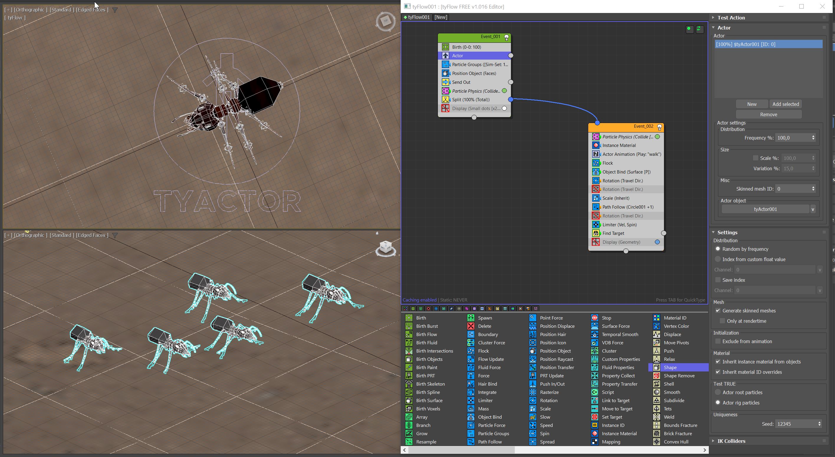

TyFlow Actor Turbosmooth/OpenSubdiv - AkiraShitamori - 07-11-2023 Hello! I am trying to Turbosmooth/Opensubdiv the actor mesh but the Actor Modifier won't read any object modifiers above the Skin Modifier. Is there a way to subdivide the mesh? Thanks! RE: TyFlow Actor Turbosmooth/OpenSubdiv - tyFlow - 07-11-2023 Yes, your options would be to either keep the Turbosmooth under your skin modifier on your import geometry, or apply it on top of the flow. Actors ignore all modifiers above the skin modifier. RE: TyFlow Actor Turbosmooth/OpenSubdiv - AkiraShitamori - 07-12-2023 (07-11-2023, 04:27 PM)tyFlow Wrote: Yes, your options would be to either keep the Turbosmooth under your skin modifier on your import geometry, or apply it on top of the flow. Actors ignore all modifiers above the skin modifier. Alright thanks Tyson! |
